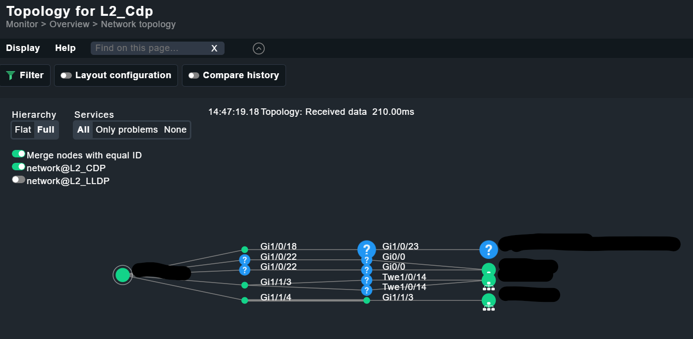

The Interfaces which are not monitored in checkmk are appearing two times in the Network Topology - e.g. Gi1/0/22 in Layer CDP:

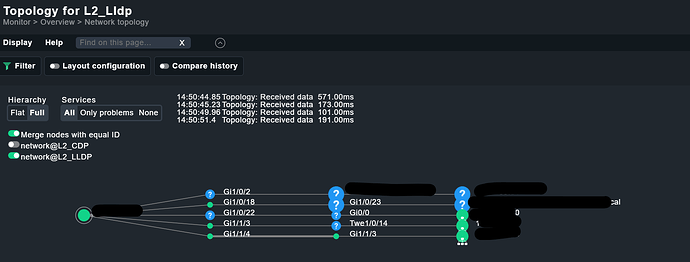

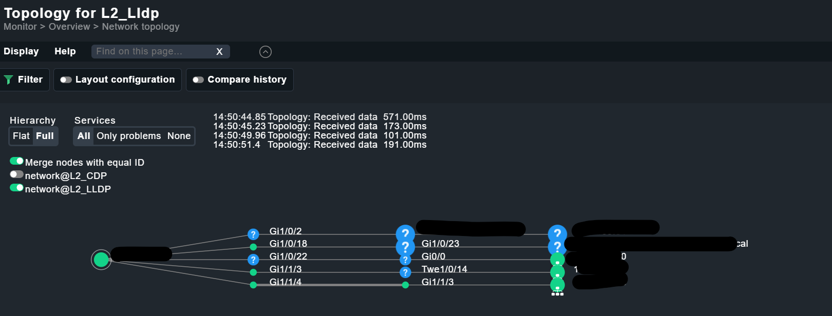

In Layer LLDP everything is working as expected:

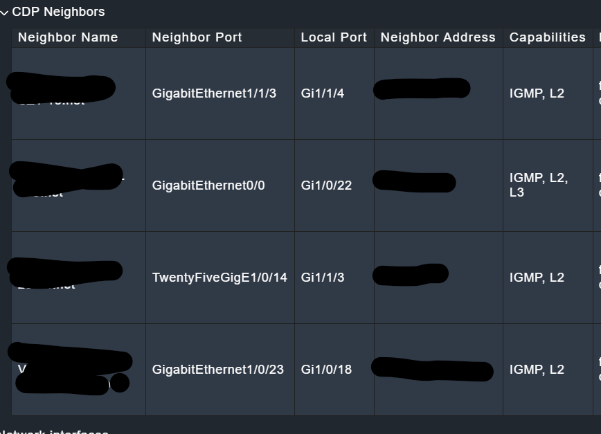

The Inventory data for CDP looks fine:

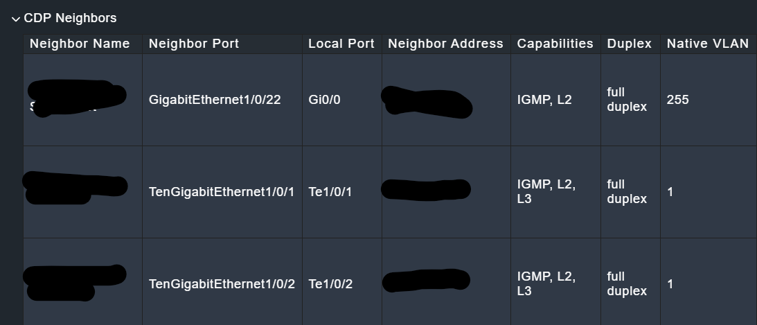

Here is the Inventory of the second device:
Gi0/0 is in the Inventory list, but it is not monitored as service on the host.

the issue is, thos ports have different names on both sides
GigabitEthernet1/0/22 ↔ Gi0/0
GigabitEthernet0/0 ↔ Gi1/022
as those can not matched to a service in Checkmk, for NVDCT this are 2 different connections.
There are two options to deal with such things
  • monitor this interfaces so NVDCT has a way to match them to a service
  • exclude the interfaces from the topology via the FILTER_BY_SERVICE_LABEL option
