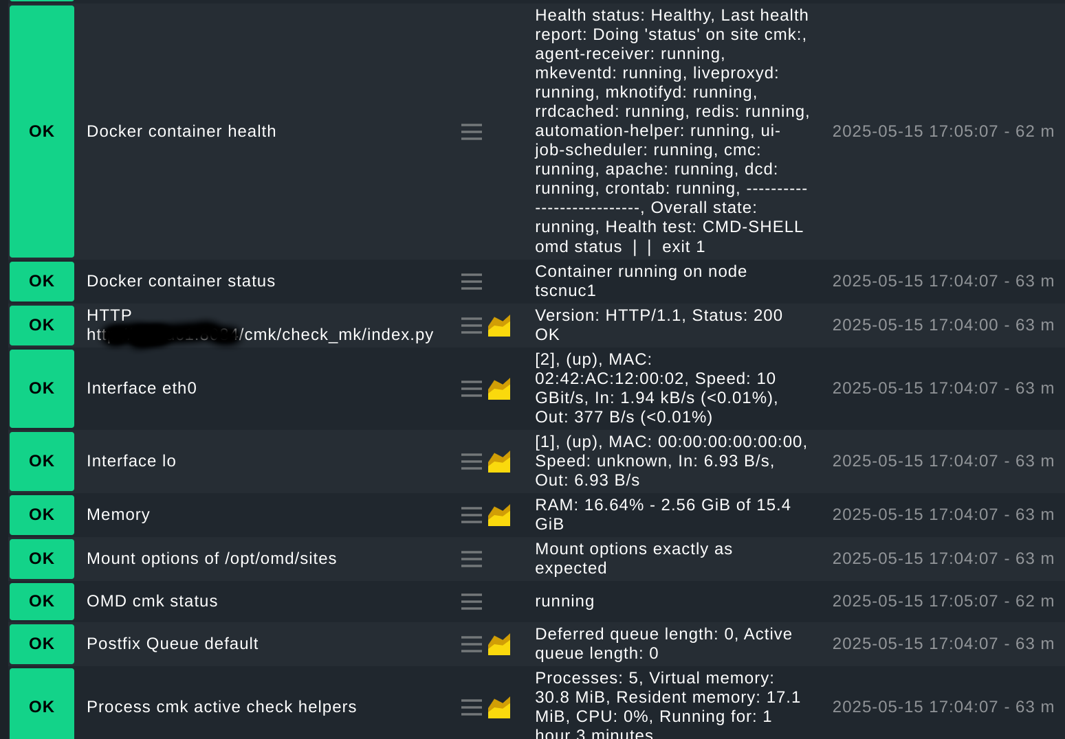

After updating checkmk from version 2.3 to version 2.4 most of the OMD site services are missing, only the “OMD status” is available:
The new default Process rules for checkmk processes is available, but they do not replace e.g. the OMD Performance services.
Docker Container, checkmk Agent and mk_docker are using the latest checkmk version - 2.4.0p1.

Has someone an idea if this is a configuration issue and if I can get back the OMD site services?
