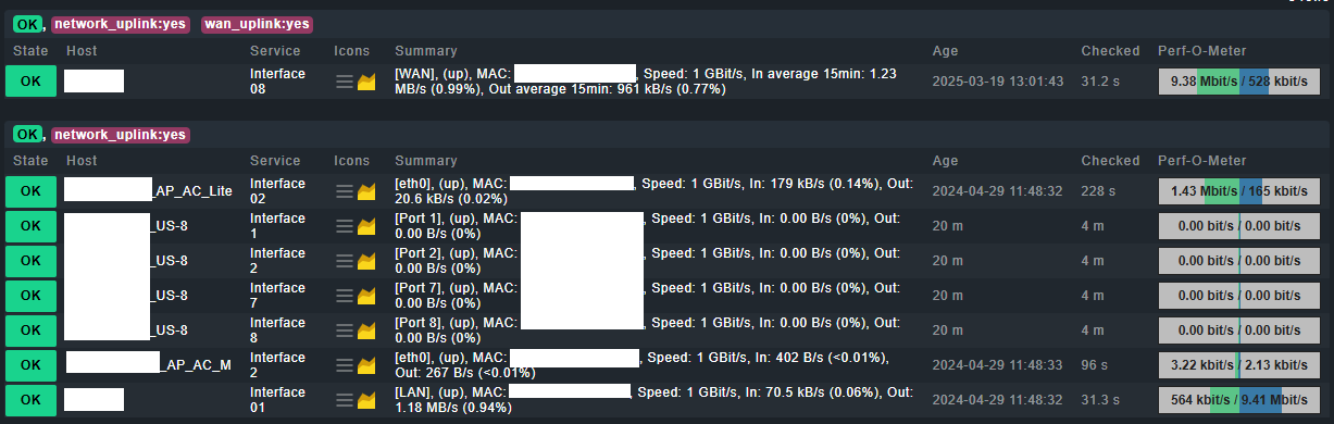

One network device not calculating data throughput on interfaces
CMK version: 2.3.0p28 Cloud
OS version: Debian 12
Error message: None for cmk --debug -vv <host> nor seen in cmc.log, however this is present when trying to download the SNMP walk through the UI:
Fetching 'walk'...
Failed: Failed to fetch data from SWITCH: cannot access local variable 'oid' where it is not associated with a value
Job finished.
cmc.log example line:
/omd/sites/SITE/var/log/cmc.log:2025-03-24 11:45:56 [5] [core 775504] Executing external command: PROCESS_SERVICE_CHECK_RESULT;SWITCH;Interface 8;0;[Port 8], (up), MAC: REDACTED, Speed: 1 GBit/s, In: 0.00 B/s (0%), Out: 0.00 B/s (0%)\n[Port 8]\nOperational state: up\nMAC: REDACTED\nSpeed: 1 GBit/s\nIn: 0.00 B/s (0%)\nOut: 0.00 B/s (0%)\nErrors in: 0%\nDiscards in: 0 packets/s\nMulticast in: 0 packets/s\nBroadcast in: 0 packets/s\nUnicast in: 0 packets/s\nNon-unicast in: 0 packets/s\nErrors out: 0%\nDiscards out: 0 packets/s\nMulticast out: 0 packets/s\nBroadcast out: 0 packets/s\nUnicast out: 0 packets/s\nNon-unicast out: 0 packets/s|outqlen=0;;;; in=0;;;0;125000000 out=0;;;0;125000000 inerr=0;;;; indisc=0;;;; inmcast=0;;;; inbcast=0;;;; inucast=0;;;; innucast=0;;;; outerr=0;;;; outdisc=0;;;; outmcast=0;;;; outbcast=0;;;; outucast=0;;;; outnucast=0;;;;
OMD[SITE]:~$ cmk --debug -vv SWITCH

It’s only this one host and it’s been going on for months and I never noticed before.

With no obvious direction to take based on the one error I found, I disabled the host from monitoring, activated, and stopped the site. I then cleared all RRD-related files for the affected Interfaces, as well as the ~/var/check_mk/snmp_cache directory. After restarting the site, I did a UI tabula rasa. The RRD info and actual RRD files were successfully regenerated, but the issue remains.
I’m a bit stumped as to what to check next. Suggestions are appreciated
For the more visually inclined, here’s a screenshot showing the issue
