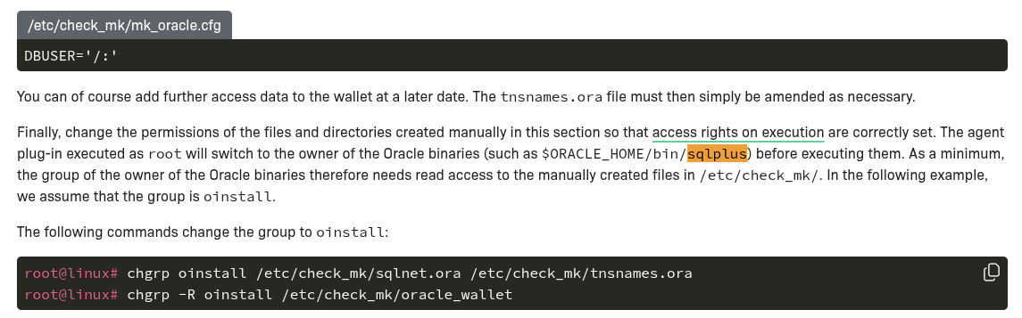

As per the docs, the agent process reads the /etc/mk_oracle.cfg file as root but will switch to the owner of the $ORACLE_HOME/bin/sqlplus owner to actually execute the sql for the checks etc.
You will typically have to have a sqlnet.ora (either empty or populated depending on your config) located in the /etc/check_mk directory as well but owner by the “oracle” user.
Or you can set the TNS_ADMIN parameter in the /etc/check_mk/mk_oracle.cfg to point to the relevant sqlnet.ora file in the ORACLE_HOME.

If you use the AGENT BAKERY you have to use the rule ‘sqlnet.ora premission group’ to make this change permanently, otherwise it will be overwritten by an agent update.
