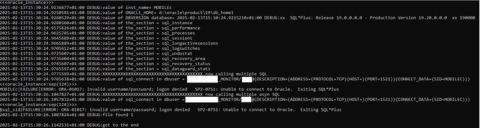

I am trying to monitor an Oracle 19 Database on a Windows server with the mk_oracle.ps1 plugin. The configuration and deployment is done via Agent Bakery and the credentials work via CMD, but the plugin can’t connect to the database.
With the DEBUG option, the plugin returns the same error:

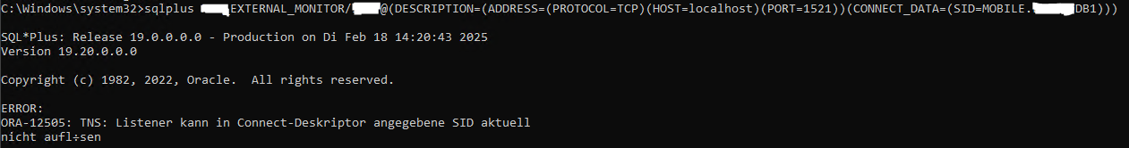

Here is the connection string with SID:

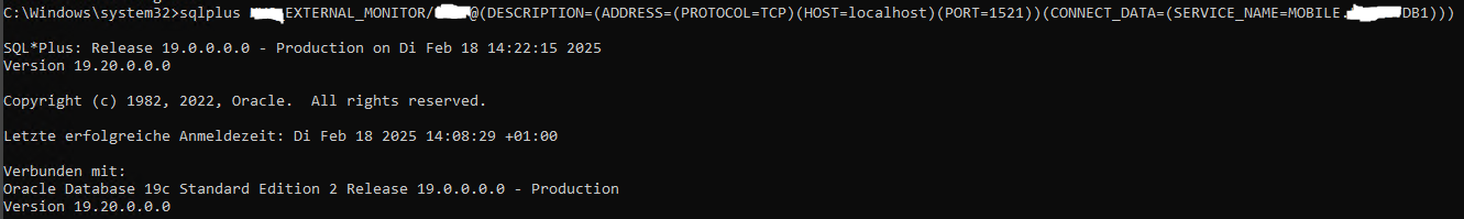

And here the same string, but with SERVICE_NAME:

I’ve configured the mk_oracle.cfg with the user and instance, but it only works with my workaround in the mk_oracle.ps1. If I use the default plugin it doesn’t work.
So for me, the problem is in line 545 of the mk_oracle.ps1, if I change the connect string to “SERVICE_NAME=…” everything works fine.
