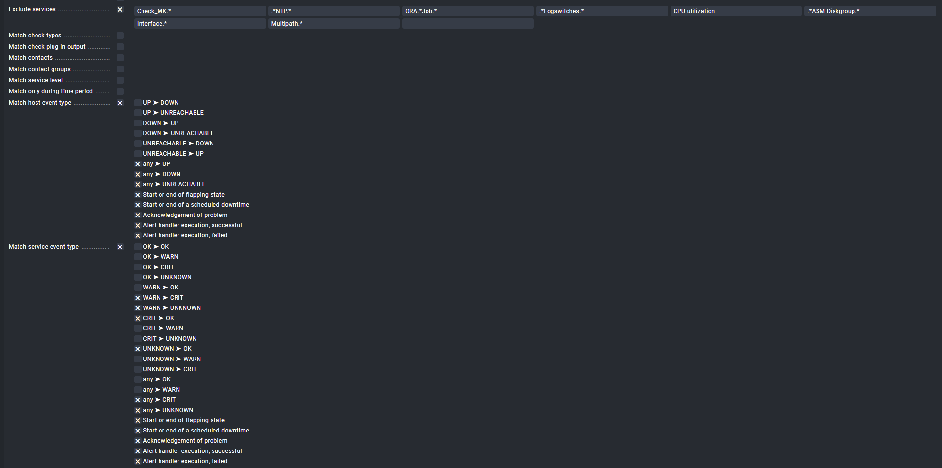

Hello!
Great name indeed, likewise :wink:
This is our 24/7 notification rules.
Further information:
Previously, when an OK is sent out, it resolves and alarm in pagerduty, but sometimes (like now) its not working, and instead is alerting that an event is OK (which we dont want).

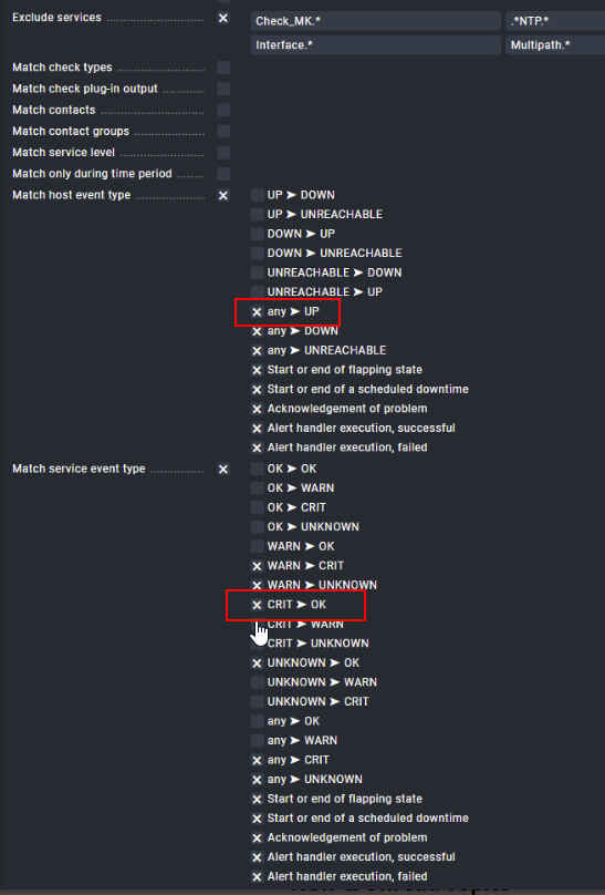

I guess this is the culprit:
Why this does not cancel a previous alert, I don’t know. I don’t know if something changed regarding PagerDuty notifications on our side, or maybe on Pagerduty side.
A quick search in our Werks did not show any recent changes.
I believe Any - > Up and Crit → OK is needed to tell pagerduty that this incident is resolved?
How else is PD notified about the change?
Is there a chance the issues lies on checkmk alerting on the OK, but not the crit before? (as if the alarm is resolved before checkmk sends alert)
I don’t know, but logically that would make sense. If there is no alert to update, then a new one is created…
Are you aware of a setting that prevents OK unless crit or warn has been sent?
