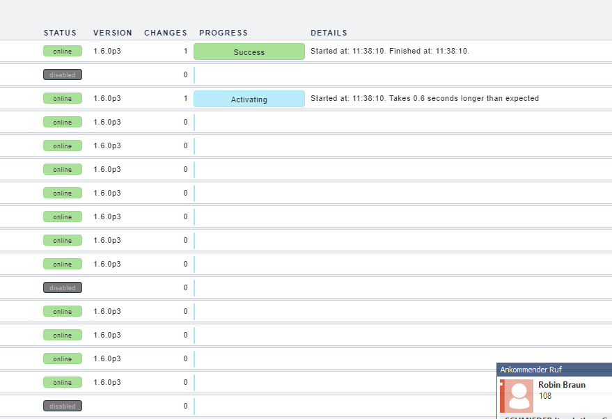

When i try to push Configurations now they actually get synchronized and activated on the slave but on the master, on “activate pending changes” , it’ll always be stuck Showing either synchronizing or activating. The changes are still shown as pending if i refresh the page, despite the site claiming the synchronization having been a success. The changes are also active on the slave and the main config, even if i then discard the changes.
