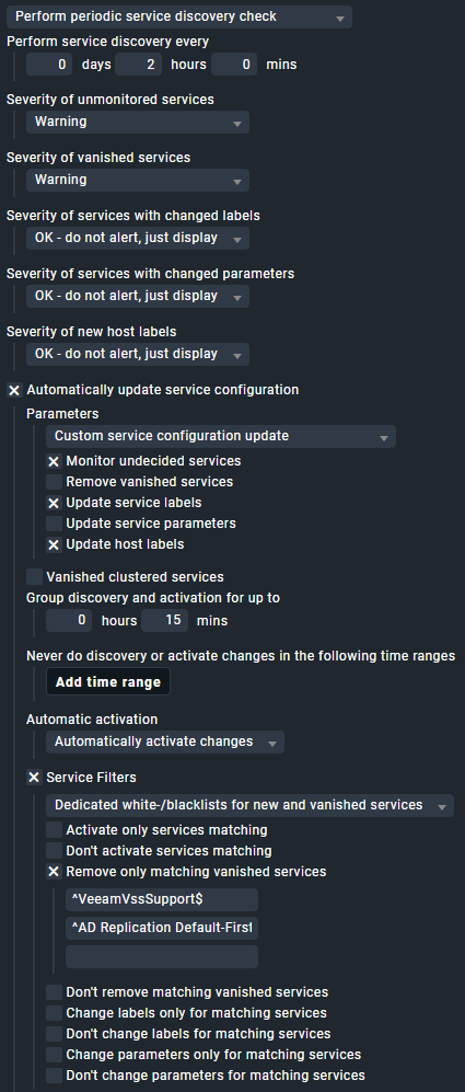

so my problem with the periodic service discovery is, that it doesn’t remove the two services I want.
I have two services that I want to automatically remove themselves. The names of the services are: Service VeeamVssSupport and AD Replication Default-First-Site-Name/DC01 (or AD Replication Default-First-Site-Name/DC02)
My settings are the following:
I am currently trying to remove the services using regex, but I am clearly doing something wrong and I cannot find my problem.
My regex are:
^VeeamVssSupport$
^AD Replication Default-First-Site-Name/DC\d+$
Thanks :slight_smile:
If you want to remove services then also the option “Remove vanished services” must be active. In you case it is not active.
I changed the setting, it works now.
Thanks for your fast answer :slight_smile:
