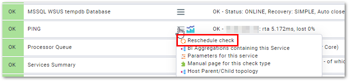

I have defined a check interval of 15s via the rule “Normal check interval for service checks”, which works.
This can also be recognized by the color of the symbol for the action “reschedule check”.
