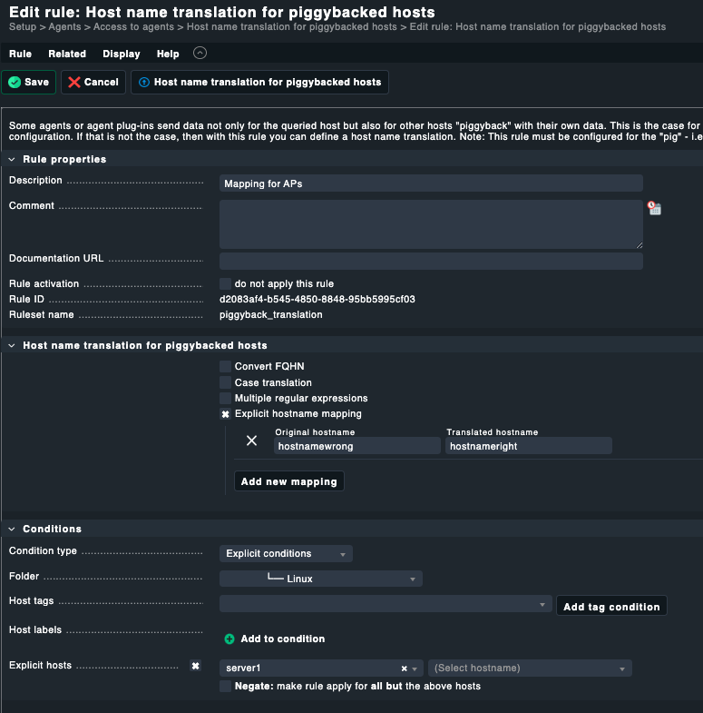

Sure - here it is:
I tried with “Case translation - Do not convert case” as well and I switched the hostname mapping.
The folder above, Linux, is the right one. I also tried with the Main folder
