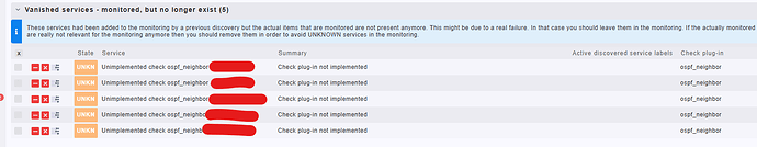

But when i go to the Run Discovery Page, the services appear at Unknown state :
I have the same problem with another plugin.
Did i miss something to the new Plugin API ?
CheckMK created Python Compiled versions (.pyc) of all plugins. Outdated versions of the compiled version have bitten me in the past. If you have not fully restarted your site, that is a quick way to check to see if that is your issue. If it is, you’ll have to do that after changes to ensure you have the latest version.
If someone else has a better way to deal with old pyc files, I’m all ears.
Thanks for the fast answer.
I did this after each modification :
cmk -R && omd restart redis && omd restart apache
Is that what you are talking about ?
Also this plugin wasn’t previously installed on this site.
I went a bit further after having a lot of issues with this when developing a large group of new plugins for a client.
The following is to be used at your own risk. While it has not caused issues for me, I don’t promise it won’t for you
find ~/local/lib/python3/cmk_addons/plugins/* -type f -name '*pyc'-delete; find ~/local/lib/python3/cmk_addons/plugins/* -type d -empty -delete; omd restart apache; omd restart redis; cmk -O; cmk -R
I also don’t know if there are better options to use. All I know is it seems to work for me.
Sorry for hijacking this channel but I’m running into the similar issue. I use some “own-developed” plugins which worked fine under CMK 2.3.0. After migrating the plugins and upgrade CMK to 2.4.0 I get the same error.
I followed your workaround solution and now the plugins/services are monitored correctly in Web-UI. Nevertheless the Check_MK Discovery service shows vanished services belonging to the plugins and when I run a service discovery over Web-UI the service shows Unknown state and “Unimplemented check” again. If I check via CLI there are no errors and everything is monitored properly.
Is there any other guess on how to solve the issue or did I miss something on the new Plugin API?
BR
After correcting the plugins and useing the API v2.
I corrected the problem by completly rebooting the omd like so :
omd restart
After that everything went back to normal
thanks for your reply. The complete restart worked partially. When I do a service discovery over Web-GUI now the plugin services don’t vanish and they don’t have an Unknown state. Nevertheless the Check_MK Discovery service summary still states vanished services.
I guess I will leave it like that und wait for some future updates.
BR
