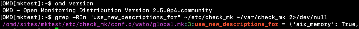

I have screenshots showing the following behavior:
  1. Checkmk 2.4.0p19
    use_new_descriptions_for is stored as a list.
  2. Checkmk 2.4.0p30 distributed/remote site after update
    use_new_descriptions_for is still stored as a list.
  3. Checkmk 2.4.0p30 fresh site
    use_new_descriptions_for is stored as a dict.
  4. Checkmk 2.5.0p4 fresh site
This suggests that the fresh-site default/config schema has changed to dictionary format, but the upgraded distributed site may not have migrated this value correctly, or the remote site receives/keeps an older representation from the central/distributed configuration.
