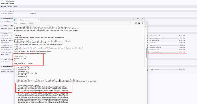

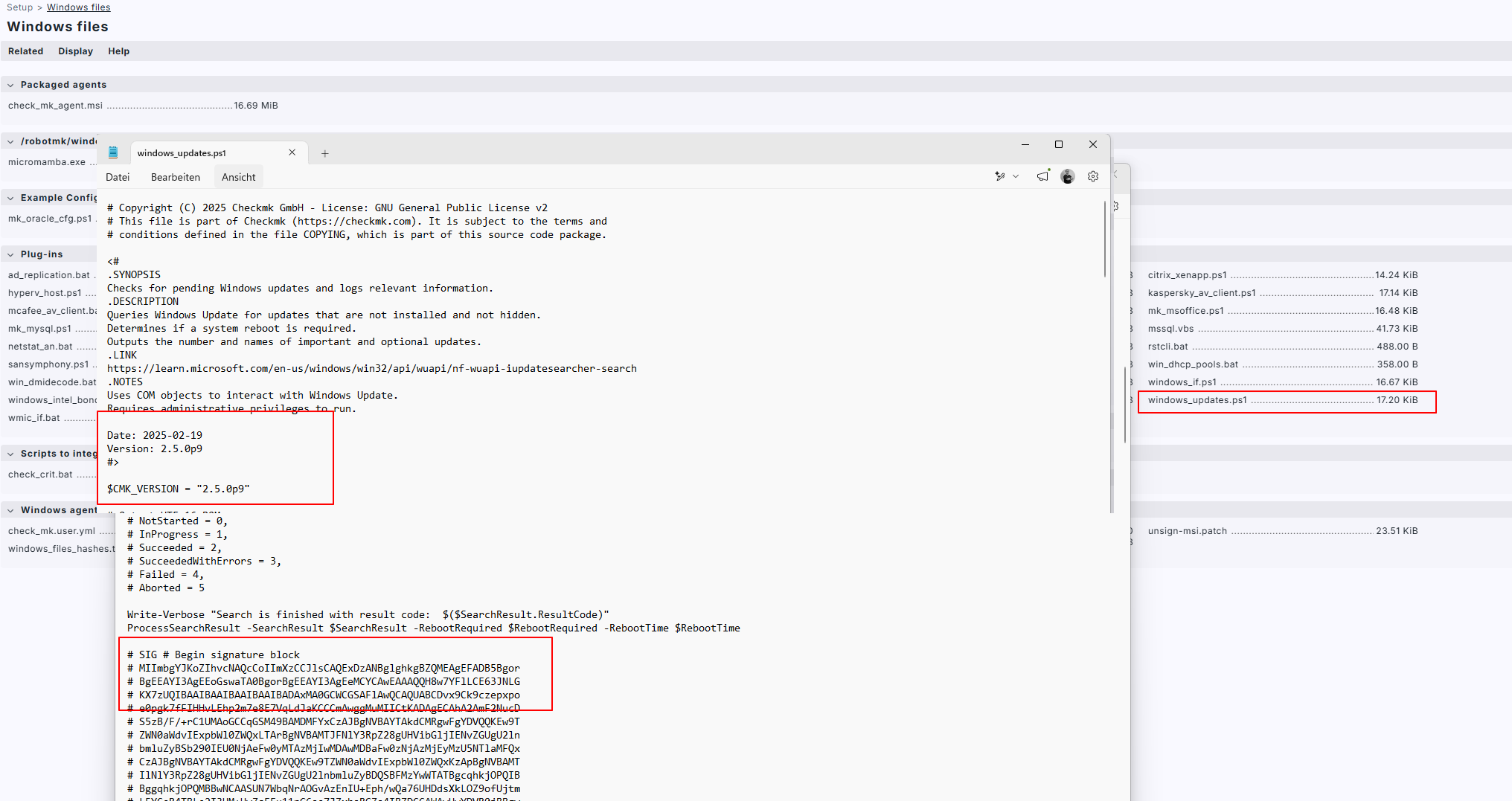

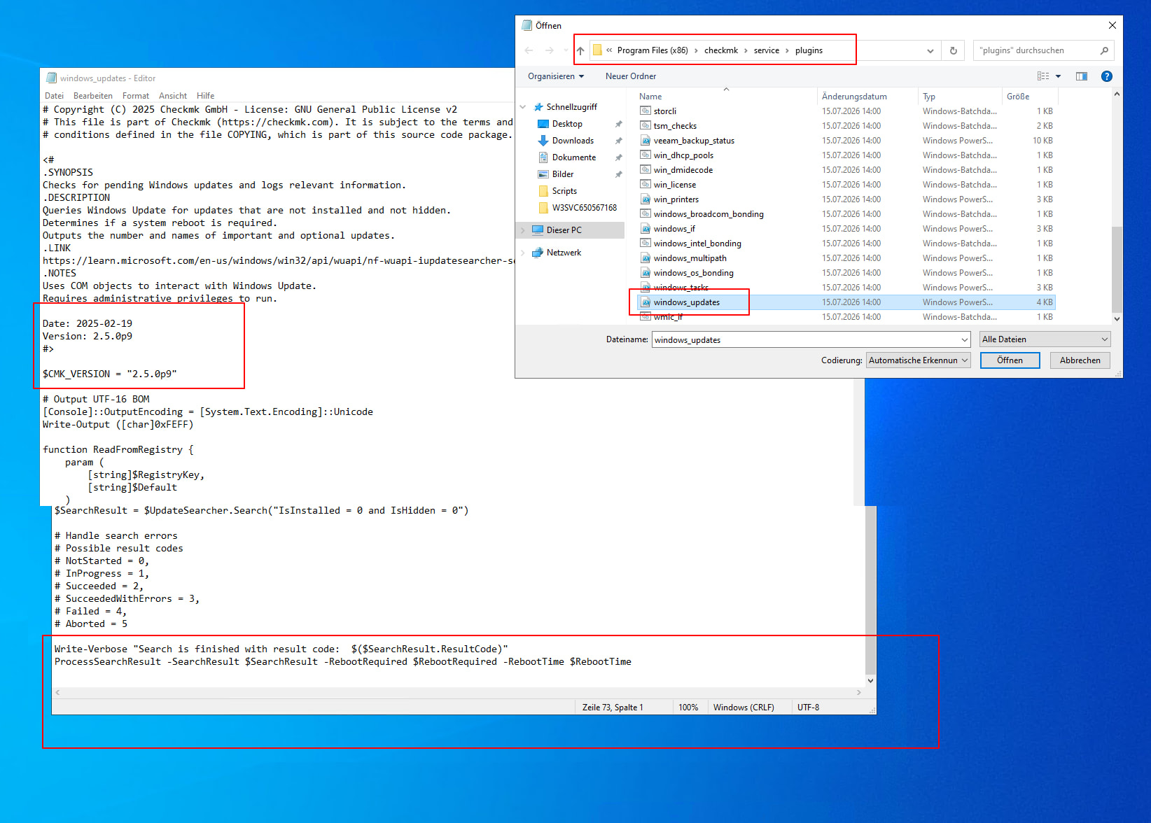

Has anyone already installed the update and had any success with it? The server has been updated, and the agents have been baked and deployed. The PS1 plugins in the Agent directory are version 2.5.0p8, but the PowerShell signatures are still missing in the scripts. Did I miss something here, or is there a bug?
Are you referring to the plugins or local scripts? I’ve updated and all of the powershell scripts under plugins are signed but the local ones that I have created myself are not signed.
The plugins included in CheckMK. It’s really strange, when I download this from the server, the signature is there. The same plugin that ends up on the hosts via the Bakery doesn’t have a PowerShell signature:
Checkmk 2.5.0p9 Pro using the Checkmk HW Appliance. If relevant.
