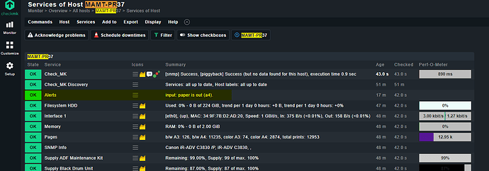

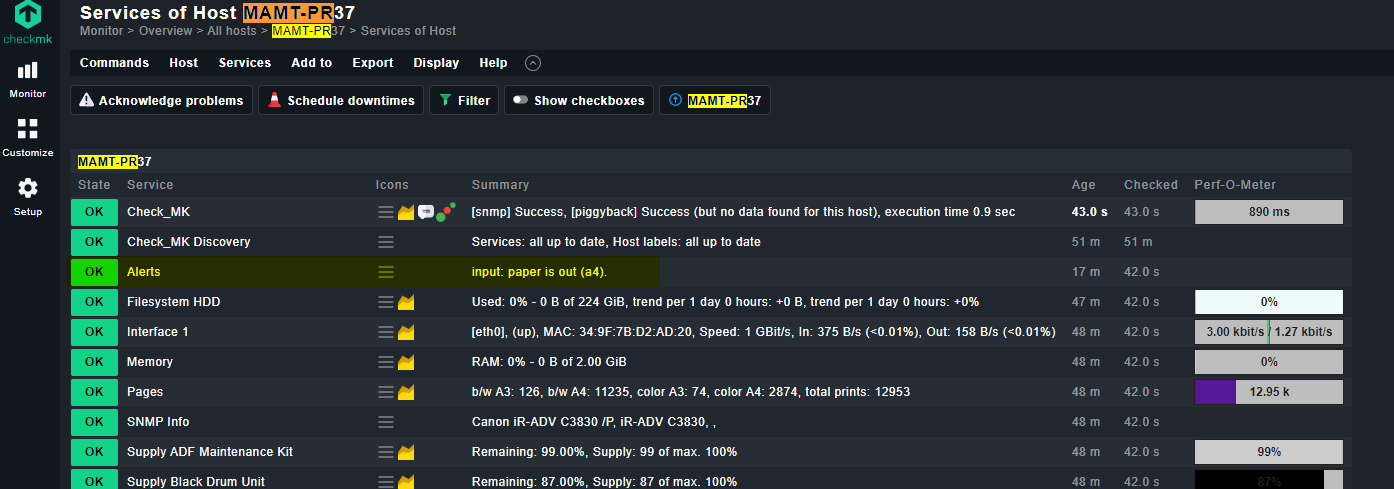

I would like to have a notification sent to me if a service is still in OK status on a printer, but the output is “input: paper is out (a4).”. has.
What is the easiest way to implement this?

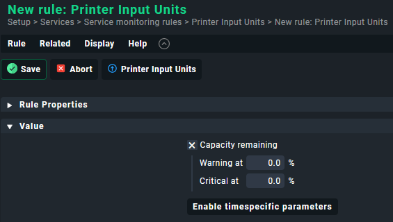

Usually printers have service checks for the input trays where they report the paper availability.
You can set rule Printer Input Units, but possible that doesn’t work if you don’t have a service check for the paper cassette / tray.
Unfortunately not in this case. It is a Canon printer

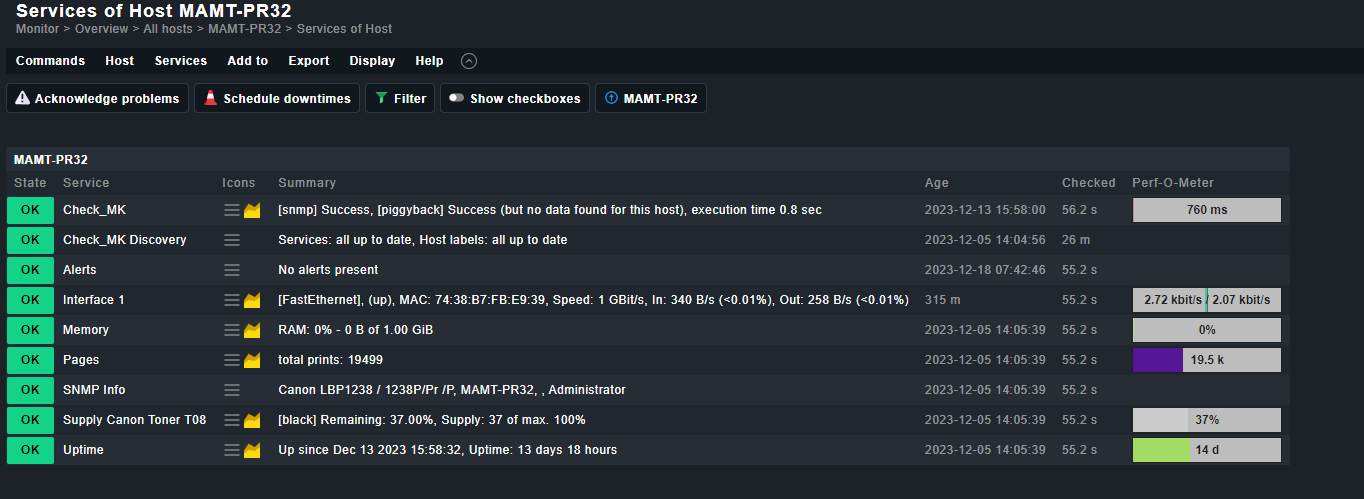

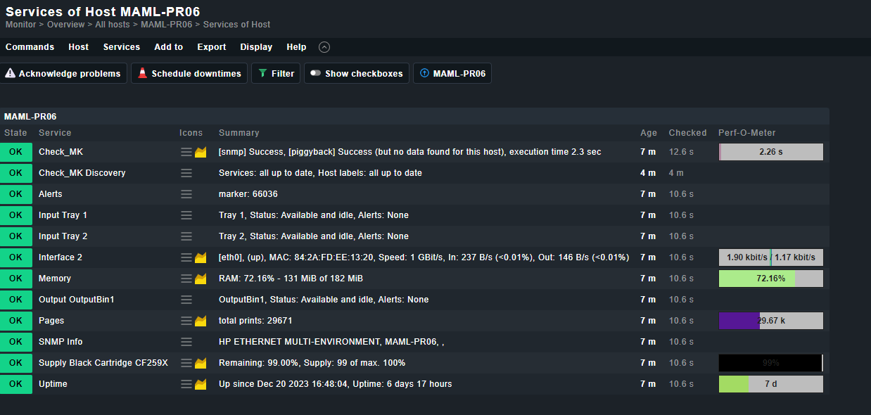

I tested it this morning with a different printer. With an HP printer, I get the paper cassette back. Not with a Canon printer. There must be some way that I can have a notification sent to me when the Canon has run out of paper in the tray.
Canon:
HP:
