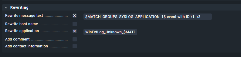

My event log entries have this format as a message:
Feb 03 23:27:55 32768.0 hcmon Detected unrecognized USB driver (\Driver\icausbb).
Ii Indeed do a rewrite as mentioned in the examples for the unknow events
Maybe it is better to turn that completely off
yes, that rewrites the logs into a string that does not match, either you delete that our you configure the regex for the target string.
