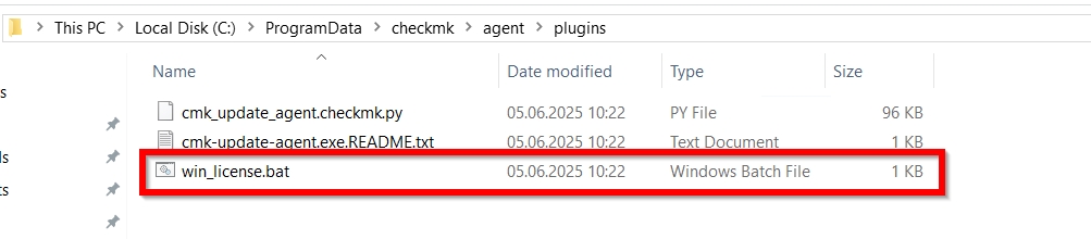

I have an strange Problem on one W2016 Server with my baked Agent which should check the Windows License Status .

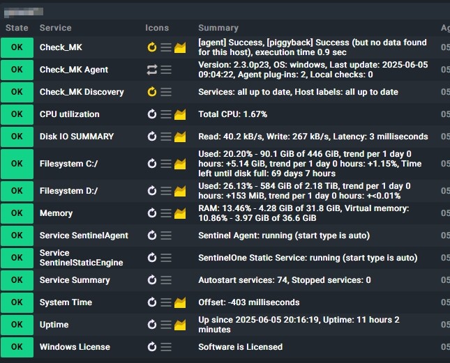

On all other 150 Servers the Check was integrated in the Services and works well .

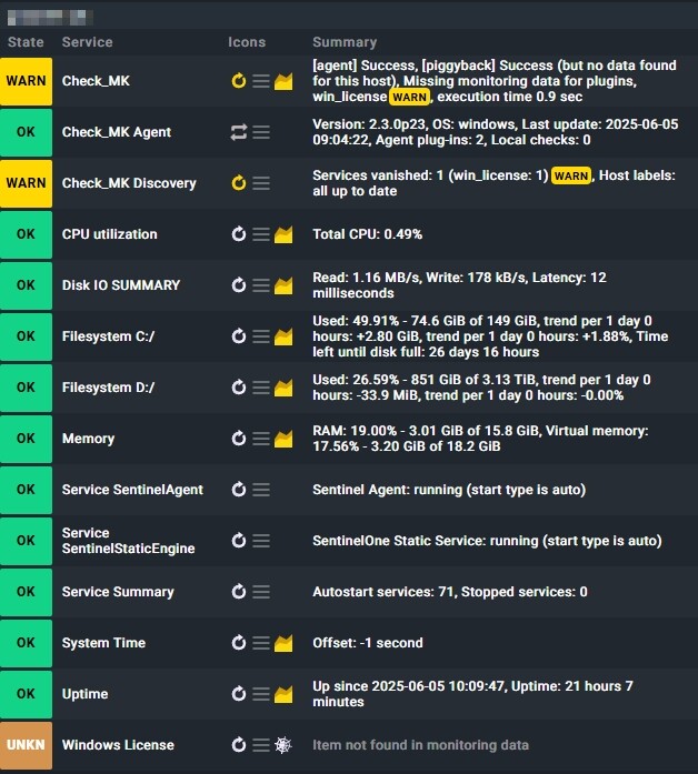

But on this Server , on an fresh Installation in Monitoring , the Services “Windows License” shows up correct and works well . But after some Time , maybe an Update of the Agent , The Host brings me an Vanished Service Warning and the Windows License Check shows
“Item not found in monitoring data” .
Here you see the difference from this special Server to the others .
I reinstall the Agent on this Server , i baked an new Agent , try checkMK Agent updater -vv
The Problem still persist .
Under Agent Update status Page there is no difference from this Servers Agent to the other Servers

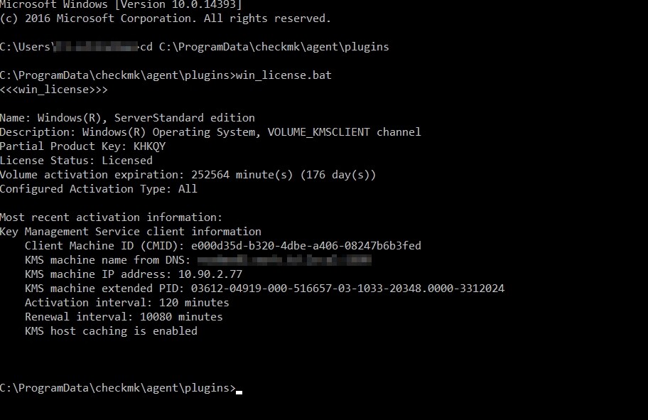

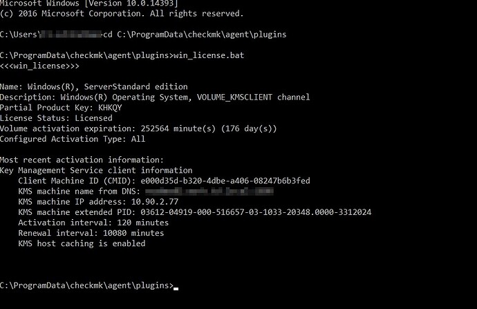

First step is to check if the license plugin script is existing on this machine.
If it is there, i would check if it shows the correct data if executed.
Also you should take a look at the agent output and inspect it for the license check section.

I found this in the CheckMK Agent Log :
2025-06-11 11:16:49.638 [srv 4212] perf: In [63] milliseconds process ‘“C:\ProgramData\checkmk\agent\plugins\win_license.bat”’ pid:[1904] SUCCEDED - generated [0] bytes of data in [0] blocks
2025-06-11 11:16:49.639 [srv 4212] [Trace] Key value cannot be processed ‘LS:SIP - Load Management’
2025-06-11 11:16:49.639 [srv 4212] [Warn ] Process ‘C:\ProgramData\checkmk\agent\plugins\win_license.bat’ has no data
