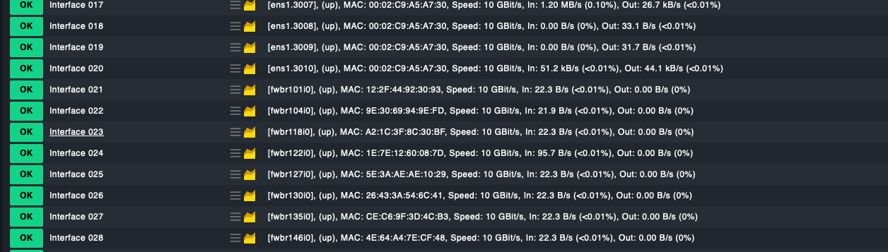

Unfortunately assigning interfaces to the cluster does not work. I filled out Clustered services rule as in the blog but the interfaces remain with the nodes and none appear at the cluster
The issue is, I think, the interface names. The are not names Interface fw… or Interface tap…
The blogpost mentions nothing of this
Edit: in case someone comes to this post in the future, the solution is to go to service discovery rules → Network interface and switch port discovery and create a rule with
