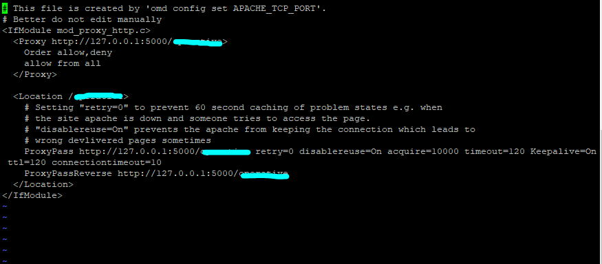

Today my CMK is not working fine, aparently they are an error with the proxy, can some one can help me ?
im using the version 1.6 Raw
Thank you.
Thank you.
Booth Apache (system and site) restarted? It looks like one of the two has a problem.
Hi @andreas-doehler yes, I restart the OMD and everything works fine, before and after the process:
Also i do it on my Slaves, because i see my slaves as down but when i try to connect to the servers i can do it and the OMD dont show problems
