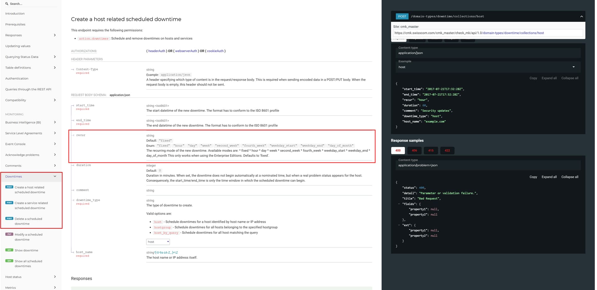

Instead of modifying the rule every month, you could automate the process by creating a new downtime each month using the API’s downtime endpoint.
Fun fact: Just like in the GUI, the API supports a recur option that allows you to define recurring downtimes.
You can find the relevant documentation in your Checkmk GUI under:
…/check_mk/api/doc/#operation/cmk.gui.openapi.endpoints.downtime.create_host_related_downtime
…/check_mk/api/doc/#operation/cmk.gui.openapi.endpoints.downtime.create_service_related_downtime

Regarding your scheduling, if you want the downtime to start on the first Thursday after the second Tuesday, that would be the second Thursday of the month or not :wink: . For such cases, you can use the Repeat this downtime Option “same nth weekday (from beginning)” — with the first downtime date setting the starting point. This would schedule a downtime each month for the second Thursday in every subsequent month.
