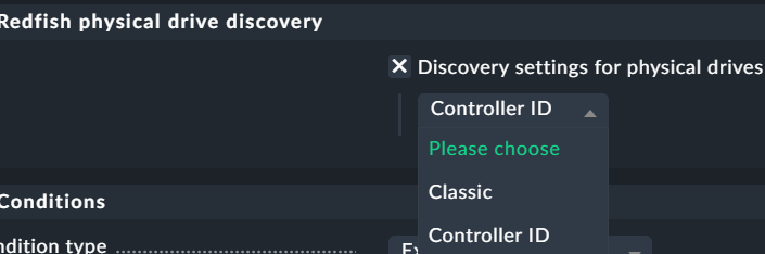

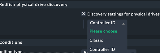

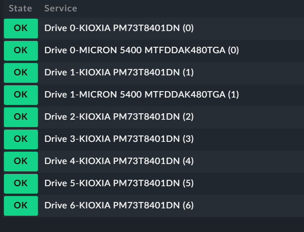

Fixed/Added function
→ Discovery Rule → Redfish Physical Drive discovery
Here you can define how drive items should be discovered. Options as it is done now or only system/controller/drive id based.

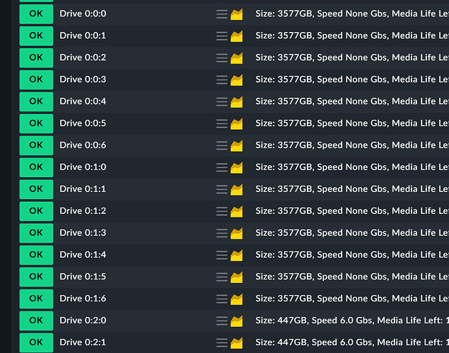

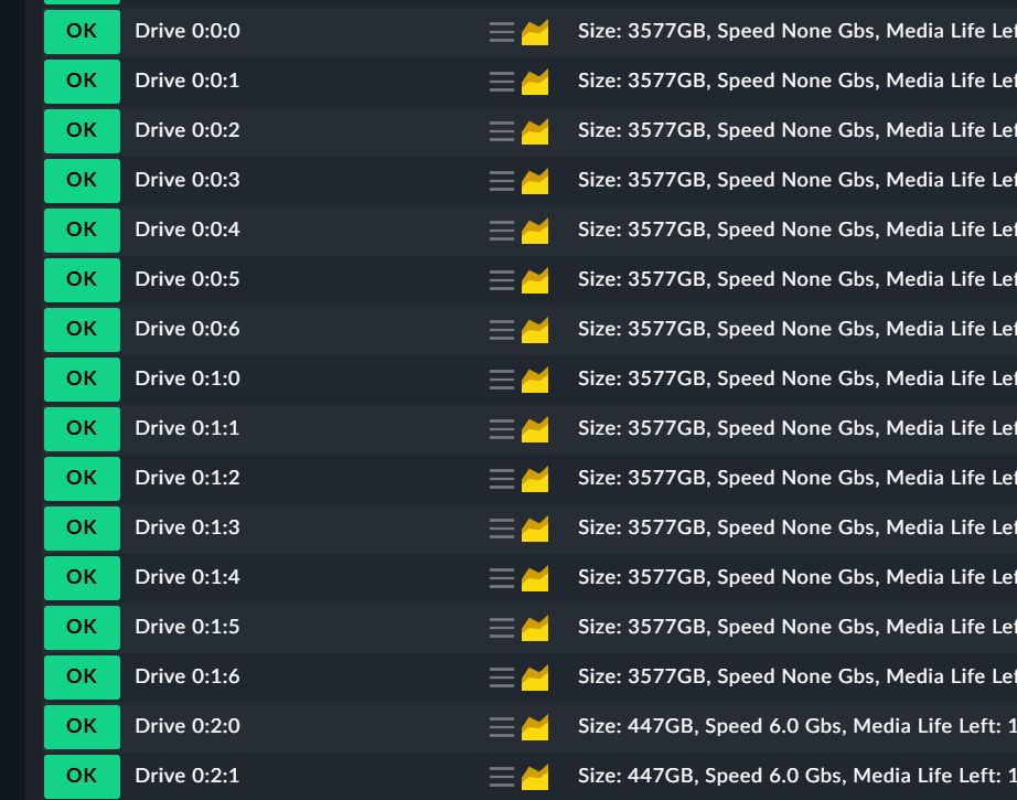

Result will look like this.
Classic
New way example with same drives
That’s the same server where seven drives have exactly the same ID and Name on two different controllers. Here the new way is needed to have all drives inside your monitoring.
In the default configuration, the classic naming is used to avoid breaking changes. But if you think not all drives are visible inside your monitoring you can switch the discovery option to check if more are found.

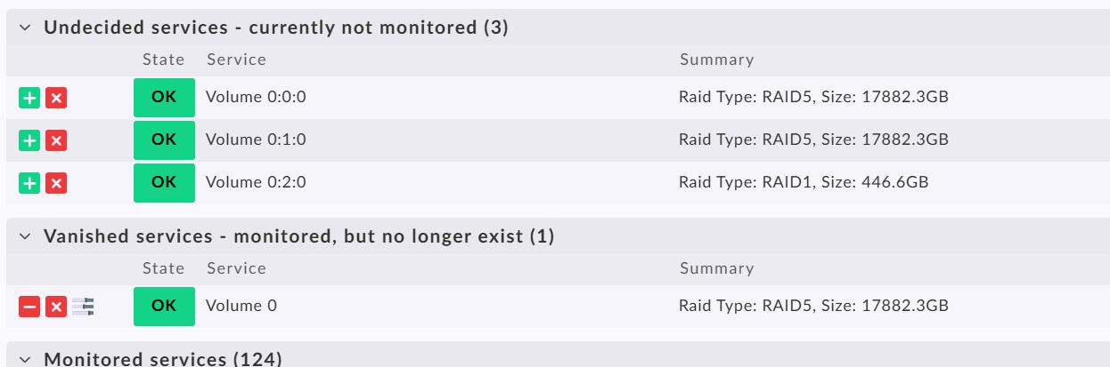

One more update. The same fix as for the drives also for the volume checks.

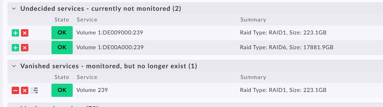

https://github.com/Yogibaer75/Check_MK-Things/raw/refs/heads/master/check%20plugins%202.3/redfish/redfish_extensions-1.3.9.mkp
In the examples on top is the new naming style on the bottom the old one.
Without creating a rule the system stays at the old style for discovery.
It is only done this way to prevent “incompatible changes” :wink:

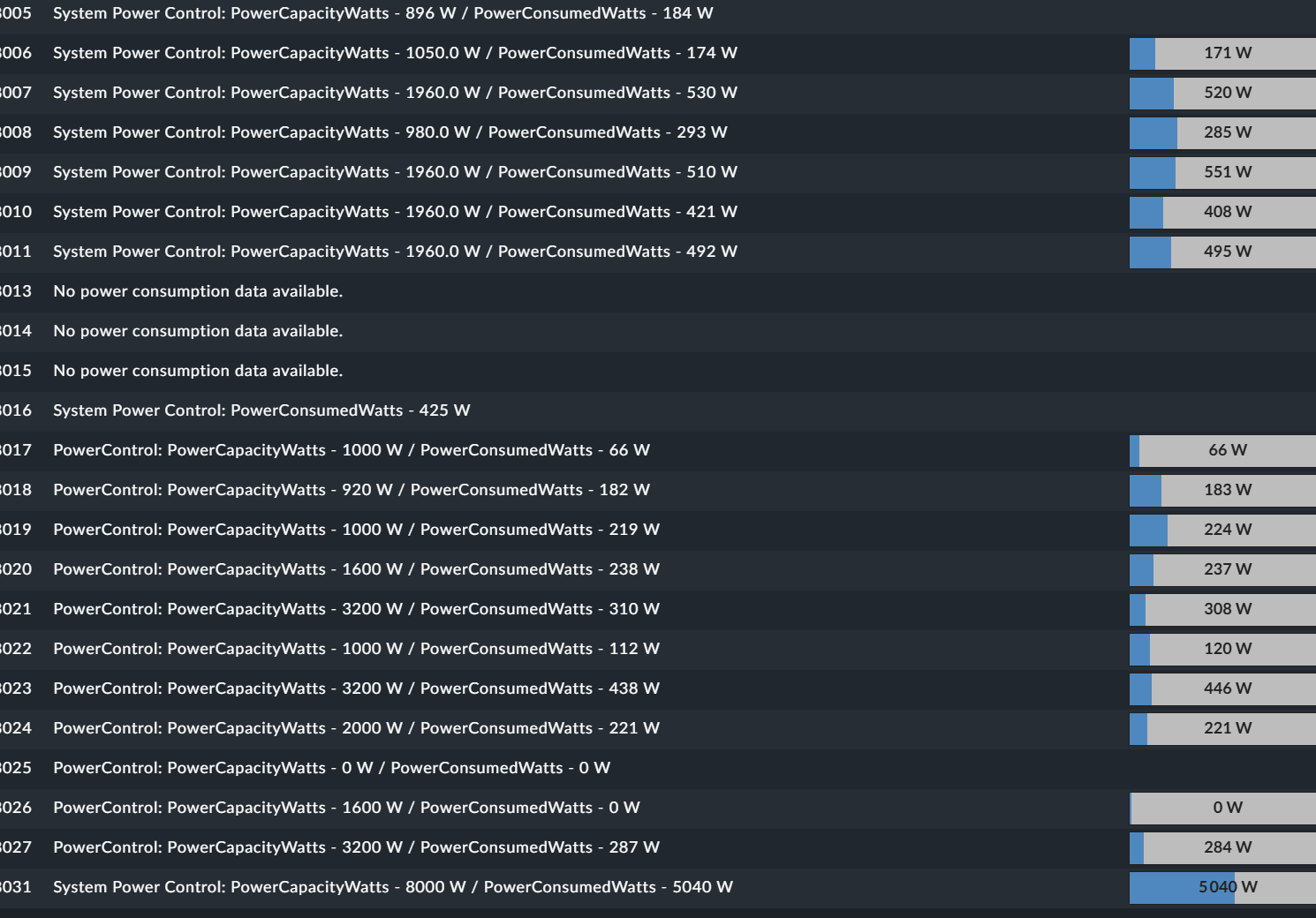

→ PowerControl is not working as before.
Before
After
WHY???

  3. PowerControl: Both redfish_power_consumption and redfish_power_redundancy were changed from single aggregated services to per-MemberId item services during the merge. This broke the output format and the service model. Both have been restored to your original single-service design. Power consumption now shows System Power Control: PowerCapacityWatts - ### W / PowerConsumedWatts - ### W again, with the “No power consumption data available.” fallback.
