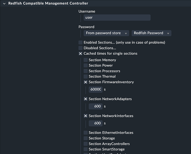

Please define for the “NetworkAdapters” and “NetworkInterfaces” section in the special agent config a cache time of 600 seconds or so.
We will see if it also goes missing for larger query intervals.
It can also be a timeout issue for this section.
You can also try with the “Timeout for connection” setting. This timeout applies to every section for fetching the data.
Sorry, but where exactly do I set this up?
Inside the special agent config.

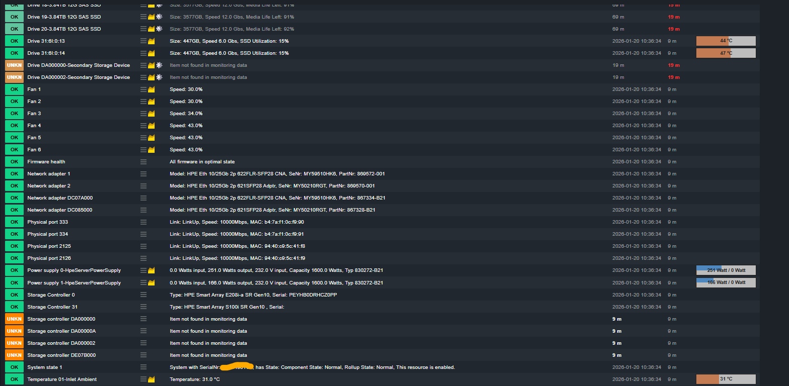

Got a similar issue, but for storage controllers. Happens from time to time ‘item not found in monitoring data’
only difference here, where the suggestion was not to monitor them, is I have drives connected to them which also go stale. (see the top 2 lines) of the screenshot
after a recheck of the alert, everything shows as it should.

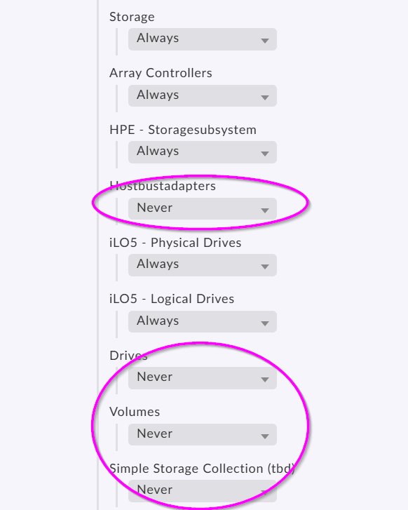

HPE iLO 5 is sometimes a little bit strange. It has data from the old HPE specific data tree and also from the generic tree for storage devices. That is the reason you see drives and volumes doubled with slightly different names.
For iLO 5 would recommend to disable the following sections inside the special agent config.
I would now test if it gets better. Beside this you can also define a ignored service rule for all the “DA…..” services.
