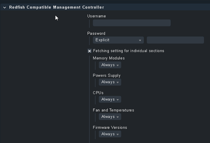

You can configure what information should be fetched inside the special agent config.
For sections like the “Firmware Versions” you should configure a high value for the cache time.

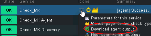

If you have configured the special agent you can also inspect the output with the “Download agent output” function inside the GUI.
