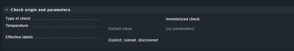

Unfortunately not, if i go to parameter of one of these services ther only thing i see is :
… so no option to adjust something.
  • Glowsome
If you press “Temperature” you can define some parameters. :wink:
This only shows no defined parameters for this check.
omg ! i must have been there with my eyes closed … i feel a bit dumb now …
