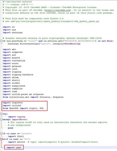

If i try to register an agent to the updater at CLI, i get a traceback:
CMK-Updater1
The Agent itself can be registered without any problem. In the Bakery Python 3.4 is baked into the package, because of Win 7.
These are POS Systems, we can´t easily update to Win > 7. We are running an extra CMK Site 2.2 for them :grinning:

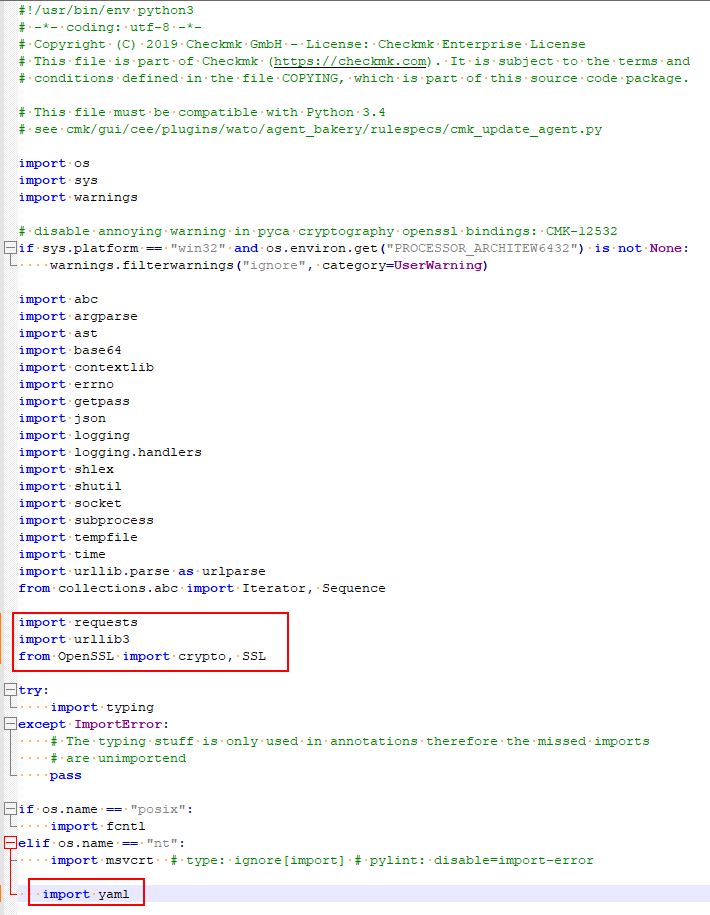

It looks like a lot of moduls are missing in the agent, nobody else having this problem?!

But i tried to expand the python3.cab, no better result. The marked moduls are missing in the python 3.4 package from bakery :frowning:
