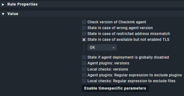

If you do not need that you can ignore the WARN by changing the parameters of this service check.
In the Enterprise Editions you can build an agent package that does not have the agent controller included. This will also remove that WARN as cmk-agent-ctl is not available on the host.

How can i set ignore the WARN by changing the parameters of this service check.
Sorry, but I just started using checkmk.Where and how can I do it?
Setup > Services > Service monitoring rules > Checkmk Agent installation auditing
Path and screenshot is from 2.1, but I assume it hasn’t change much in 2.3. (-;

The shortcut to the parameter ruleset of a service is via its action menu (the three lines in the icon collumn).
