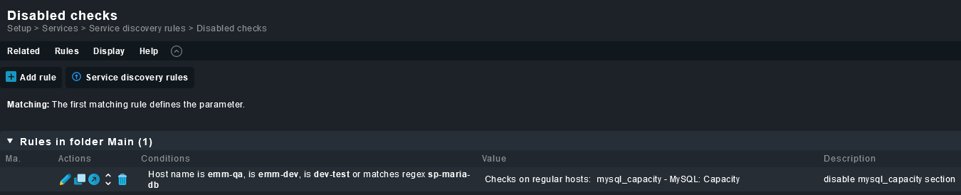

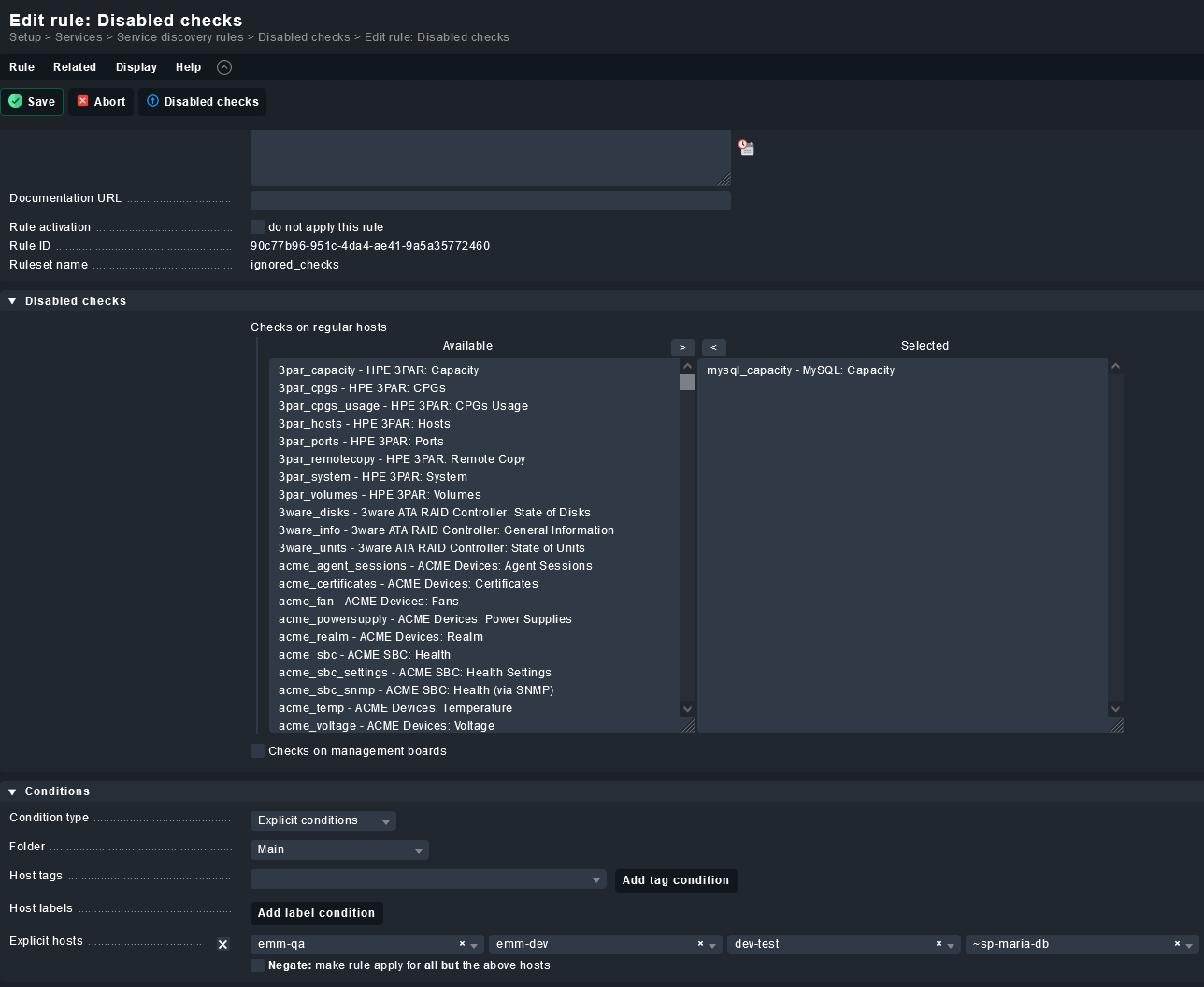

shot in the dark, but would you mind sharing screenshots of the rule + the Setup Menu and the hosts location + a view of the service in the host?
Maybe the issue is not with the regex but something else? (I guess we’ve all been there, looking at a problem for too long that one focuses on the wrong aspect)
Sure, I’d be happy if that would help finding what I probably have missed…
As you can see, the rule definition is recognized as a regex beneath three other explicit host names
All hosts mentioned in this rule reside in exact same host folder.
Defining e.g. sp-maria-db1 explicitly works as expected; rule is applied and service is disabled for sp-maria-db1 then.
Changing rule using regex as shown above, does not :roll_eyes:
