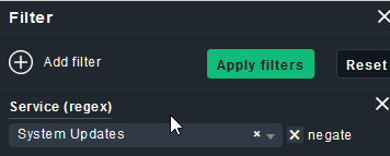

While this dashboard is now showing me all “CRIT” and “WARN” issues, I would like to exclude only a specific CRIT service (system updates) from this custom dashboard.
Is there any way to do this or should the dashboard be set up differently from scratch?

you can filter the dashboard and exclude the System Updates service:
In case you maybe want to exclude more services in the future, you can either extend the Service(regex): Service1|Service2|etc
Or you set a service label on the services you want to exlude (via rule) and then exlude that service label in your dashboard. (which I like a little more, it scales better if you have at some point dozens of niche services to exlude + you can do other things with that label + comment the rule etc.)
