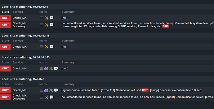

How do I remove the Check_MK Errors for some devices that do not support the agent?

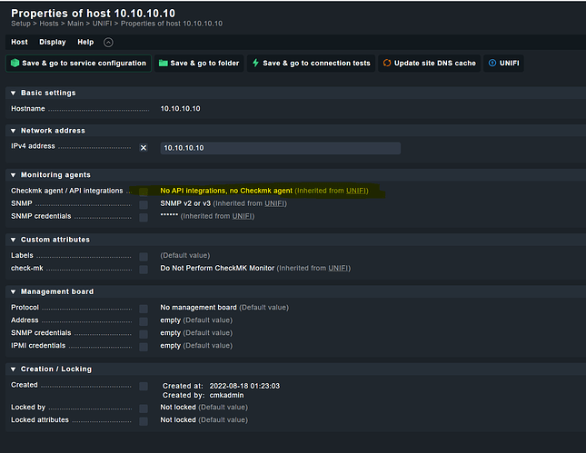

For the shown device “10.10.10.10” you have configured “SNMP” and then the “Check_MK” service must exist as all the SNMP queries are done by the “Check_MK” service.
The discovery service says correctly for this device that the SNMP credentials are not correct or the system has no active SNMP.
If you only want a PING on a device you need to also configure the device to not use SNMP.
