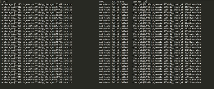

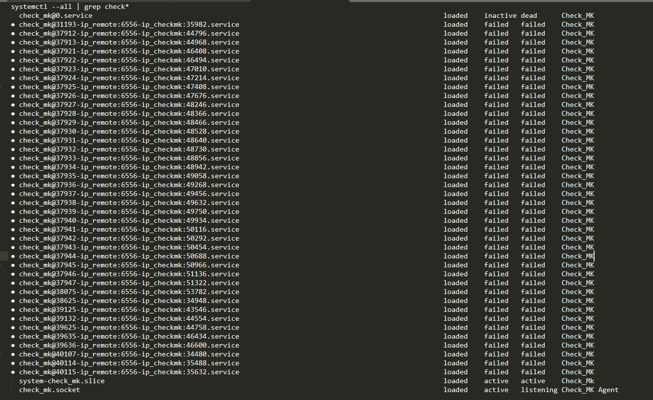

Next I list the systems services and I get what I show you in the image
[user@server system]$ systemctl list-units
Is this possible to remove it?
Execute “systemctl reset-failed”
