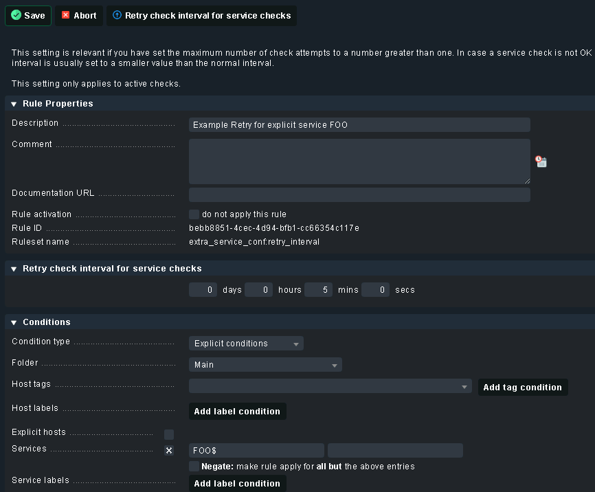

For example for the retry on service you can use
Setup > Services > Service monitoring rules > Retry check interval for service checks
Try hitting setup and using the search there to find the other metrics as I believe there are rules for each one that will allow you to build rules to do exactly what you’re asking for. Also note the warnings with the rules about the effect on other settings (retry > normal interval in this case).

My question is more focused on how I can have a configuration that applies to many services, and changing that configuration affects all services. A way to group. Is there any way? I have tried with service labels, but there can only be one key defined in the rules.
Hi @alz0
The services (or hosts) a rule applies to is determined by the conditions. So if you don’t define any conditions, the rule is applied to all services / hosts. If you define a condition (i.e. a name, or a regex, or a tag, or a label, or a specific folder, or, or, or… ) it is applied to all those services or hosts where the condition matches.
Read more here: Rules
If you define a rule in the main directory, it is inherited by all folders below.
Read more here: Host structuring
Hope this helps.
Elias
Yes, sure it helps, thanks @elias.voelker
@alz0 Ah, my approach was based on thinking you had a specific service or services you wanted to modify. This still works as @elias.voelker mentions globally if you leave off the service condition to the match.
