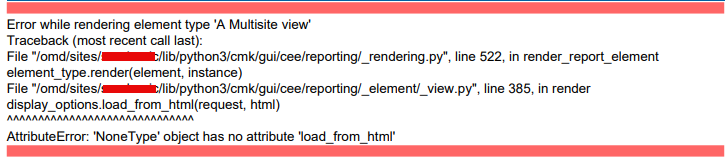

since the new update to 2.4.0.p2 on Ubuntu 24.04, the Report Scheduling does not work anymore.
It’s a report, that sends via email and the pdf is attached, now I get this in the pdf:

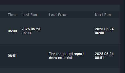

I tried to recreate the report with a new one, with a new schedule, but everytime I get:
“The requested report does not exist.”
The strange thing is on both, when I execute them manually, it works completely fine.

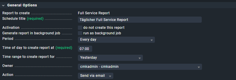

Good Morning @SAGAlvin and @opa114,

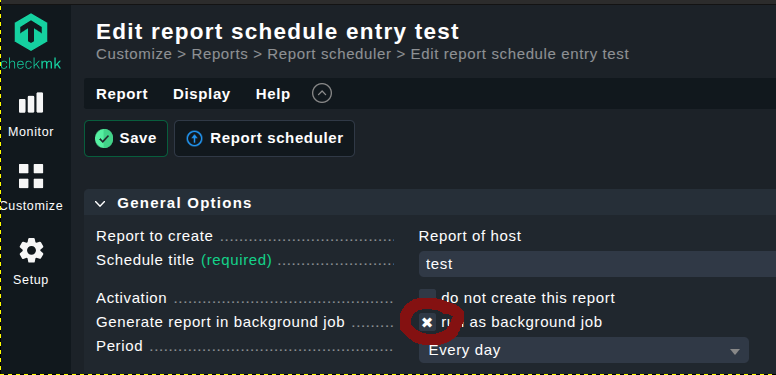

can you please check, whether those report schedules are configured to not run as background jobs?
If that’s the case , this might be related to Werk #18074: Render all scheduled reports without error.
You could try to run as background job:
The fix would then be available with the next patch release shortly.
Sunny Greetings
Hartmut
Morning @HartmutLeister,
Currently I’m at Version 2.3.0p33 and the report does not run as background jobs.
Best regards
Alvin
same here @HartmutLeister . Report scheduler is not running as background job (checkbox is unchecked). I’m using latest 2.4 (2.4.0p5)

If you set run as background job to checked, would that yield you with working scheduled reports again?
Problem seems to be fixed at least with Patch 7 (2.4.0p7).
I didn’t have patch 6 installed, only patch 5 (it didn’t work then). But now with Patch 7 the scheduled report is working again.
