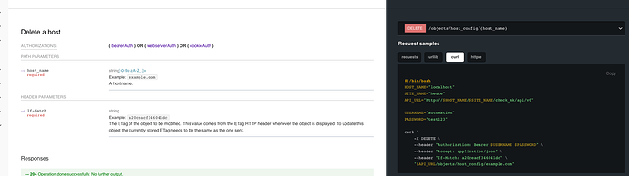

I am looking for some guidance on the new REST API available in version 2.0. I am trying to send an API call to delete a Host but when I try to run the command I get the results below.
"title": "Precondition failed",
"status": 412,
"detail": "ETag didn't match. Probable cause: Object changed by another user.",
"ext": null
The same host I created through the API and looking through the info, I didn’t find an “ETag” value anywhere in the API return. I have searched through the API document and can’t seem to find where or what generates an “ETag”. Provided is a screenshot of the example provided by the CheckMK API Document.
Does anyone have any idea where I can find the “ETag” value and/or what it’s purpose is? It’s very strange that the only time it seems to ask for it is on DELETE API calls as opposed to GET, POST, PUT calls.
All other commands seem to work perfectly fine. I was able to add the host and activate the change through the API without any issues.

As far as I understand the REST API, you first have to query for the host object. The ETag is embedded in the HTTP headers and must be used to alter the host object. The ETag is a temporary ID to prevent changes in between requests from other users.
There will be an API client implementation available that should handle these things.
Ahhh that’s where it shows up. Thanks for pointing that out! Within my automation, I will probably have to query the host first to grab the ETag value before I delete it. A sucky extra step but makes sense.

For future reference: this behavior has been removed in March 2021, Werk 12274: API: removing etag requirement in delete endpoints
The workaround is therefore no longer neccessary for DELETE actions.
