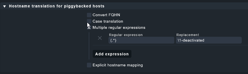

Yes: you can use the rule “Hostname translation for piggybacked hosts” to e.g. rename all the incoming piggyback data to an invalid hostname, i.e.
first of all, thank you for your fast reply and for a working solution! :slight_smile:
I wouldn’t say that the piggyback data is transfered from one site to another. Both sites are using the checkmk agent of the source host, so both sites get all the piggyback data. With the renaming I am now able to ignore the piggyback data for one site which is exactly what I wanted.
