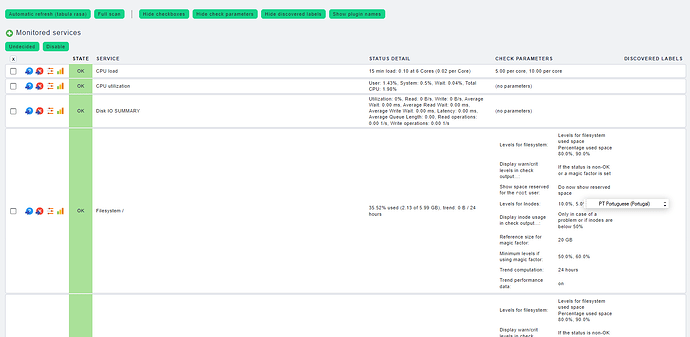

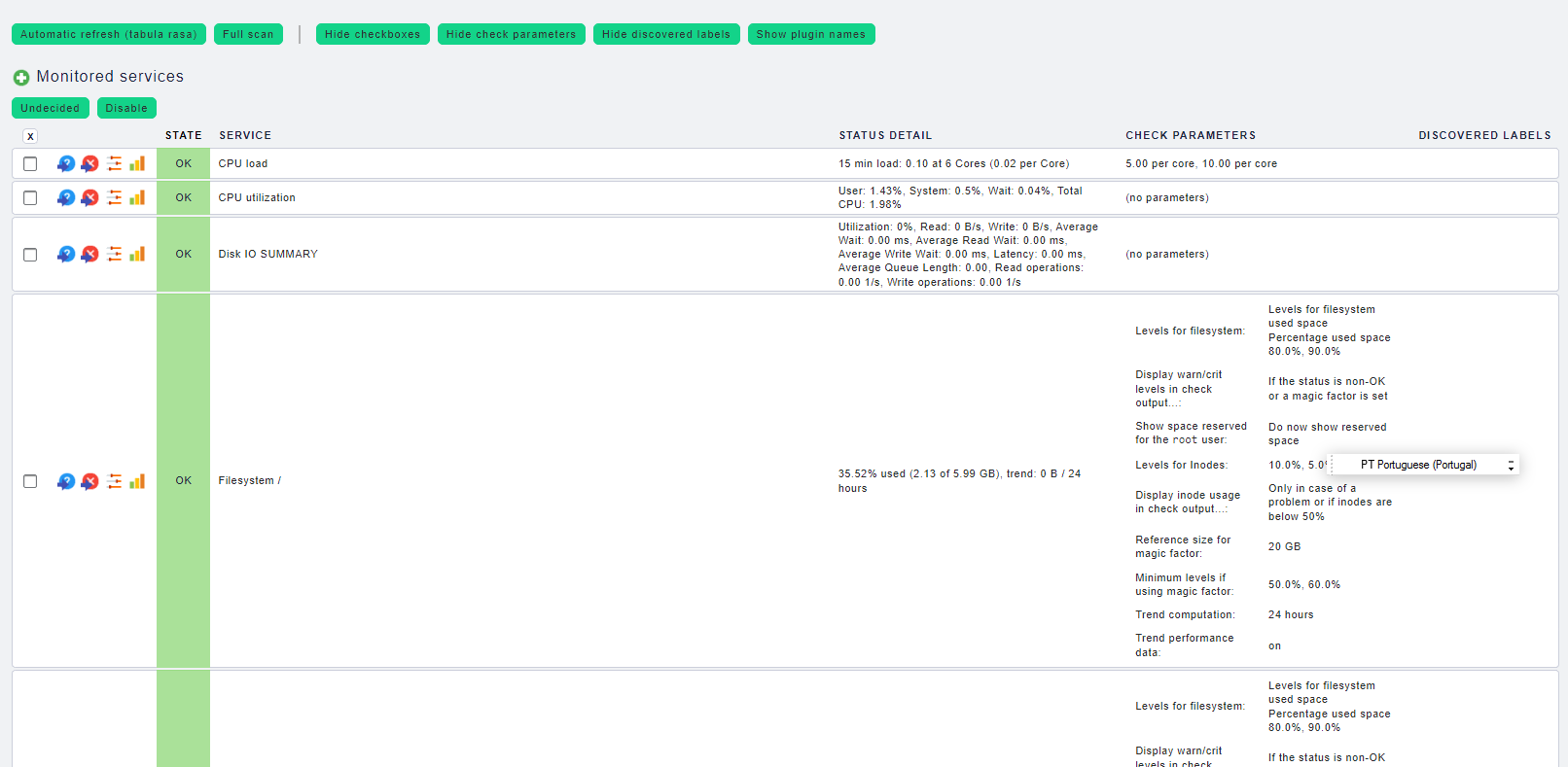

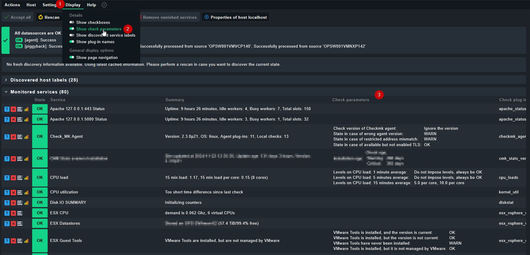

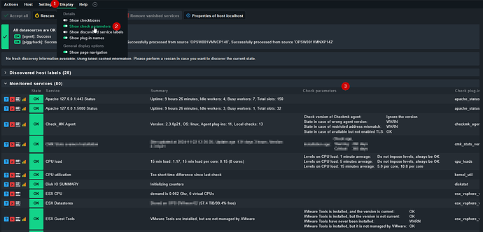

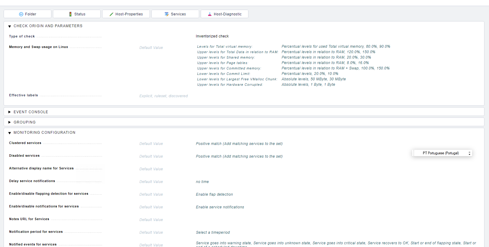

if you need at least a best-effort solution, you can open the service discovery of any host (or device type) and select “show check parameters”
Hi Gerd,

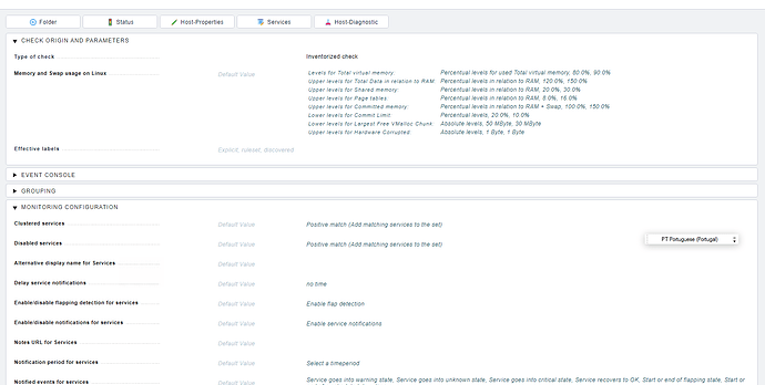

Im using v1.6.0p30 and i can see the default parameters in host>wato>services>view/edit parameters for this service.
The problem is the need to automate the grab of the default thresholds. There is to many hosts and alarms by host to do it manually.

I found the check_parameters that you mentioned Gerd :slight_smile:

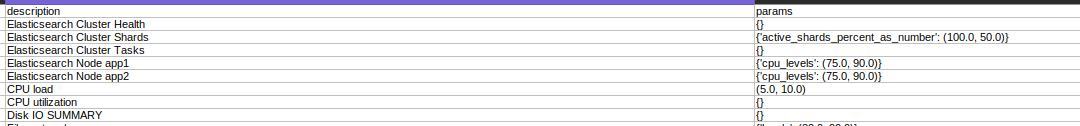

From the output columns we have check_type, item,params, description. Im only considering for the csv the description, params and then appended the hostname
csv_writer.writerow([hostname, description, params])
