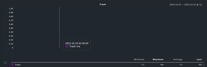

But it does not generate an rrd graph over this check. I can see that it recognises the performance metrics:

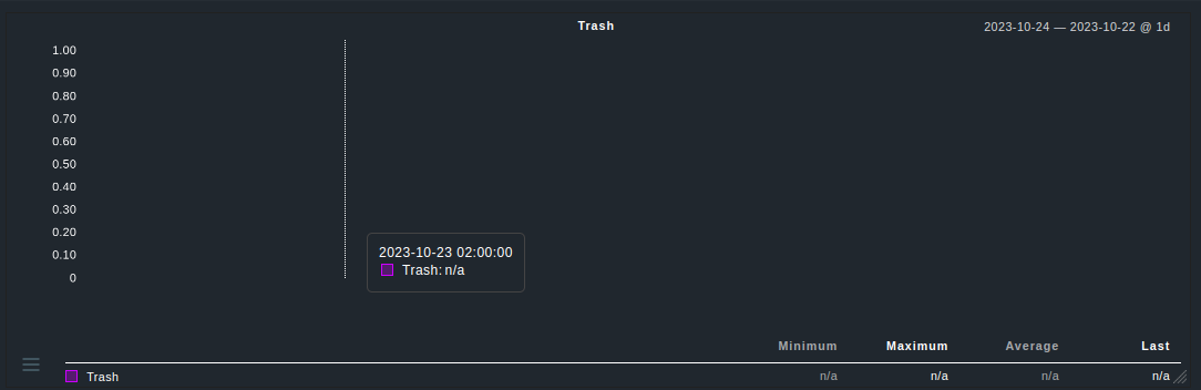

But this is all I am getting:
I waited 4 days since the last changes, so its definitly not an timing issue.
I also converted the rrds after changing the rules with: “cmk -v --convert-rrds --help”
What am I doing wrong?

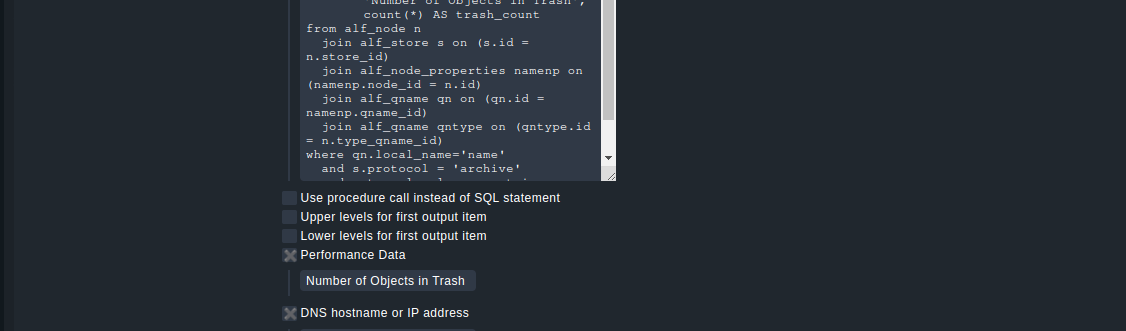

1st question do you use rule Check SQL Database and did you enabled perf data in the rule.

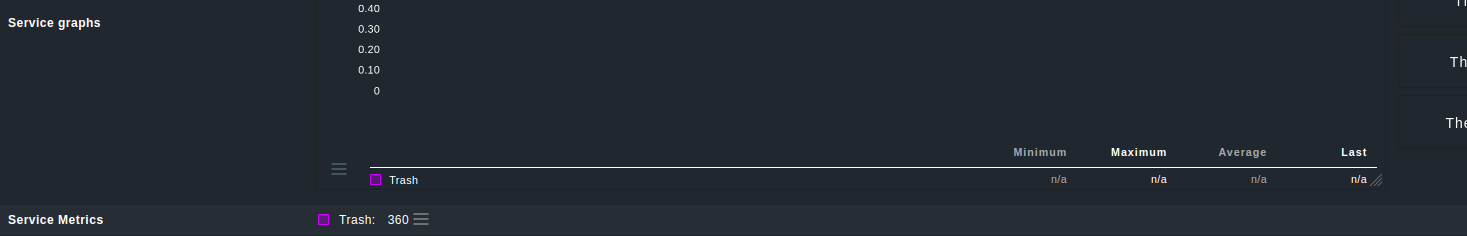

Second question do you see perf data in your service:
it looks a bit different than yours (perhaps version differences?), but I have set it:
and I can see it in the service:
