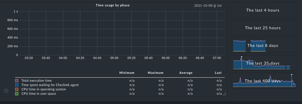

Further more, when adding a new host to this slave, rrds are not created, the host doesn’t have a folder in ~/var/check_mk/rrd/
The Graphs look like this on hosts of this specific slave:

Unfortunately I couldn’t fix it and I don’t know what is the reason, but to get the site back I did the following:
create a backup without rrds -N
option
create a new site
restore the backup to the new site
reinventory all hosts in the new site
stop and rename original site
stop rename new site according to the original one
start the new/old site
