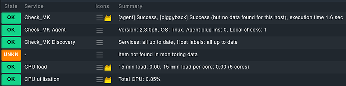

But on the checkmk server, all I see is this:
Can someone please guide me in the right direction to have this sorted? Thank you!

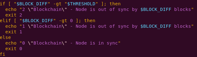

Thanks for your reply. I’m not using Nagios at all. I just want CheckMK to pick up the values. I referred to the Local checks document and this is what my script looks like now:
if [ “$BLOCK_DIFF” -gt “$THRESHOLD” ]; then
echo “2 "Blockchain" - Node is out of sync by $BLOCK_DIFF blocks”
exit 2
elif [ “$BLOCK_DIFF” -gt 0 ]; then
echo “1 "Blockchain" - Node is out of sync by $BLOCK_DIFF blocks”
exit 1
else
echo “0 "Blockchain" - Node is in sync”
exit 0
fi

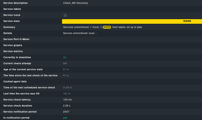

But now, it comes up “Unknown” on the server:
Any ideas?
The backward slash isn’t showing up on this post. But it’s definitely in my script:
Any help, please?
You must make a service discovery for that host. Because of your old check checkmk thought there was a check named - (just a minus/dash sign), but the actual name is Blockchain.
Also, let your script always do an exit 0, even in the WARN/CRIT cases. Any other value cause problems when the script runs asynchronously (say, every five minutes only or so). Exit values != 0 are used only if the script itself could not run properly (missing permissions or something like that).
Besides that, your local check looks okay to me.
That saved the day! I’ve also changed the exit codes as you suggested. Thank you very much, sir!
