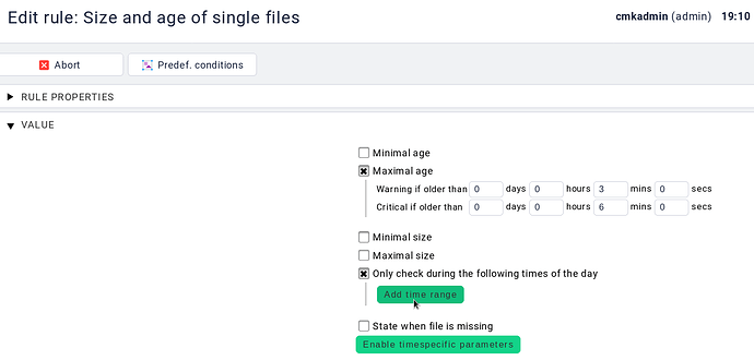

how about using the fileinfo-check and the rule Size and age of single files?
Karl
