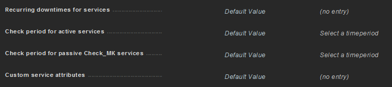

The other day I was created parameters for active check period. After finding out that there was still the notification, we found out that process was passive check. That works
My question:
Is there a list of what checks are active checks and what are passive checks? I couldn’t find this in documentation.
This may give you better explanation what is the difference between the two:
  • Other than that, your Check_MK service check is Active check and the rest of the service checks are Passive.
    Also, any check that is configured via the ruleset [Active checks (HTTP, TCP,) etc.] under WATO >> Host and service parameters is also an active check.
Hmm this will help me. So a list of this is not present oke.
So I will have to teach my users :sweat_smile: . I must agree that is was quit confusing when both option are show under parameters
