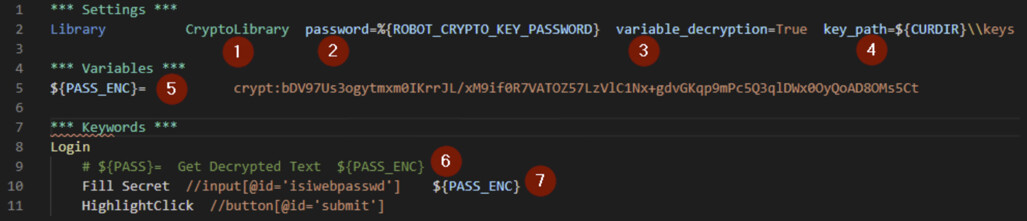

Instead, my best practice is to create an environment variable (example: ROBOT_CRYPTO_KEY_PASSWORD) which I access inside of the script (2).

By the way: by default, the CryptoLibrary stores the keypair in the Python site-packages lib folder.
This does not make sense to me at all. It is important to have the keys in the repository.
This video shows how to
  • create a keypair inside of the current RF project directory (folder: keypairs)
  • encrypt a secret
CryptoLibrary-encrypt
How to decrypt a secret (normally not done on the CLI but in rare cases it can be helpful :slight_smile: ). Here, you must beforehand set the keypair path again.
CryptoLibrary-decrypt
