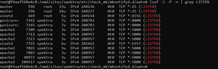

Update:
i found that the checkmk container from our main site isnt even listening on port 6555. ive already recreated the container and restartet the site. running omd status outputs Overall state: running. any idea why this is happening? the docker host is listening properly and no other firewall is blocking either:
Regards
