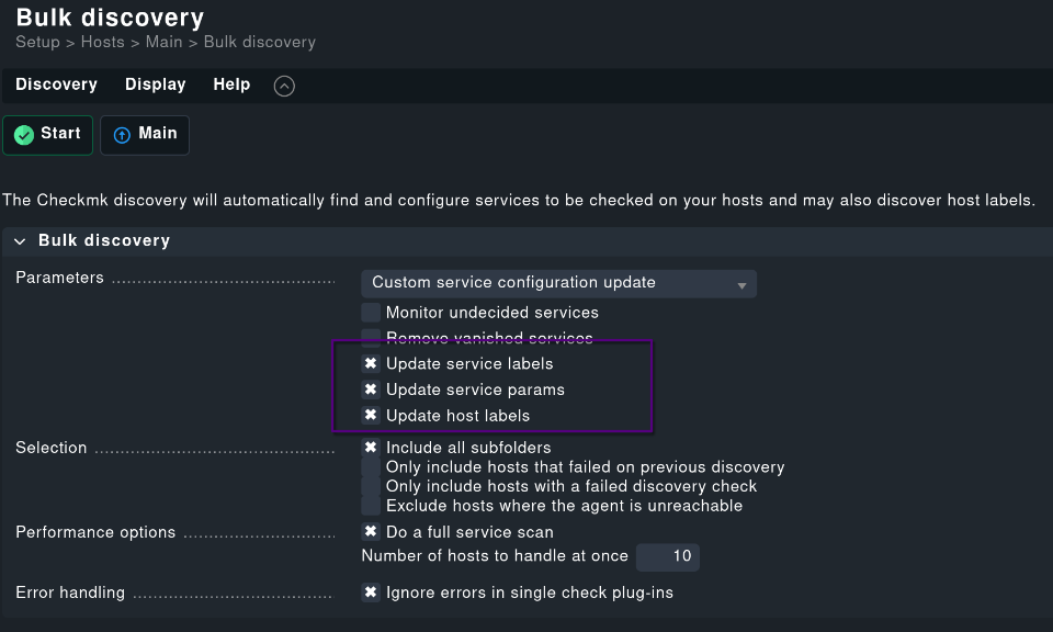

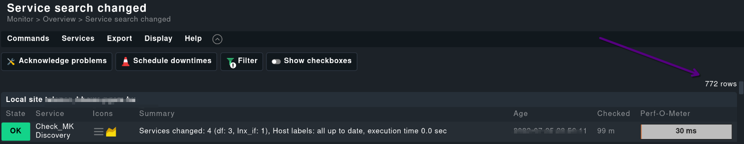

After upgrading in the test env to it - ~800 hosts from ~2500 has “Service changed” in Discovery. How to update it bulk. I do not see option for it. Tabula rasa is not ok here.
I do not see proper option for bulk to accept the service change.
Hi Daniel!
Thanks for testing the beta! This should be fixed now: Werk #17962: Bulk discovery: Apply service changes if 'Update host labels' is selected
To confirm this is the same issue, you could try to deselect “Update host labels” as a workaround.
