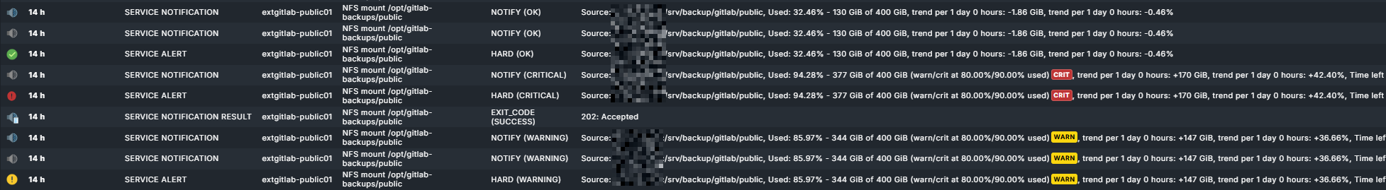

what is best-practice to prevent short living issues (Warning) for a specific service?
I’ve a Teams notification setup, and the service Warning is just for 2 minutes.
Given that I get:
and 2 minutes later OK:
at the moment I set the service check interval to 6 hours, but this doesn’t solve the problem.
here’s the event history:
any idea how to catch this?
