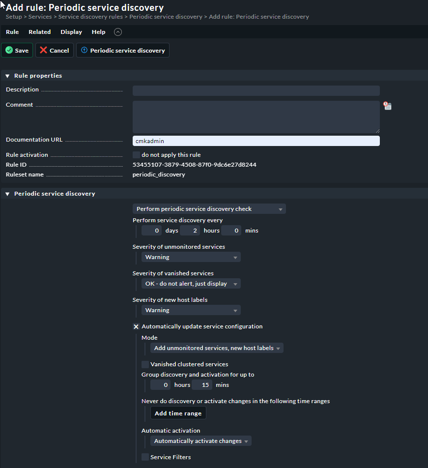

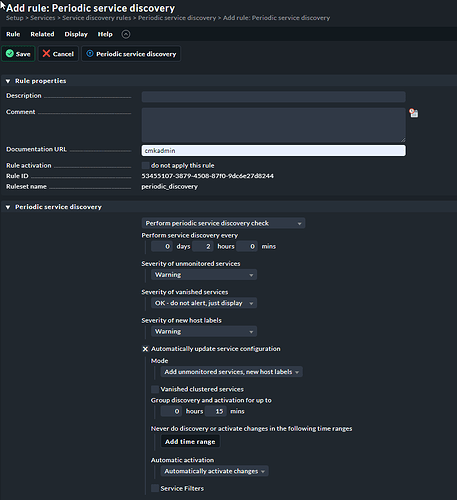

i able to disable the non required services, but now only problem left is to keep the undecided services with OK Status to monitored , how we can do this auto? It should not be manual.
Hi @manojr2k
you could use the periodic service discovery rule for that:
That and much more is all described here: Understanding and configuring services - Detecting and monitoring elements of a host
