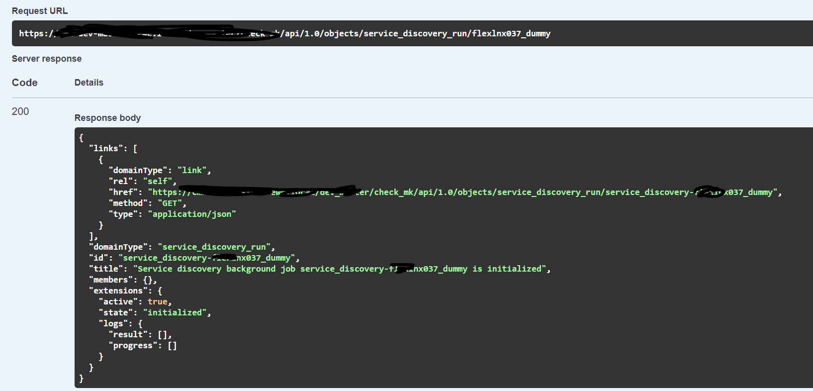

Hi all,
we are trying to do a service discovery in 2.1.0p34.
The refresh option of the service discovery gives us the information that the Service discovery background job is initialized.
When we try to get the result of the job via the Endpoint /objects/service_discovery_run/{host_name} it still keeps saying that the job is initialized:
I also can’t see the Background job in “Background jobs overview”.
It seems that the Refresh option does not start the Discovery for some reasons.
Have you see a similar behaviour in 2.1 or a solution for this?
Best Regards
Thomas
We have found out that this is related to the distributed monitoring.
When the agent is on the central site everything is working fine.
When the agent is on a remote site we got only the information from the Endpoint /objects/service_discovery_run/{host_name} that the job is initialized, BUT it is running in the background and working. You only can’t get the state…

Hi Thomas,
we are aware of this problem and will fix it with one of the next versions.
Problem is that with the options “refresh” and “tabula_rasa” you will be redirected to the service completion endpoint. This endpoint can’t find the background job if it’s running on a remote site.
