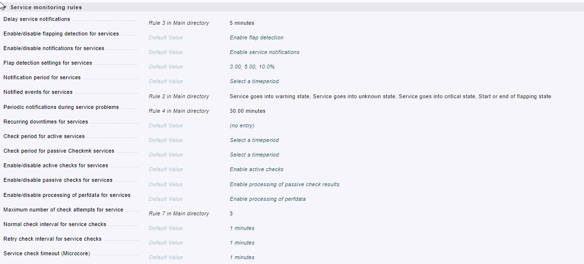

some services that have notification delay and/or check attempts configured will send alerts on the first change of state.
Here is an example
Is that any kind of wrong configuration, or a bug? If i remove the service from cmk and discover this again, it will works. So that i think thats the configured rules are ok.
Any Ideas?
This is on the remote site, and you spool notifications to the central site for delivery. How does it look on the central site? Also, you use periodic notifications, so maybe the notifications that is triggered is actually from an older event?

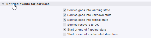

Hello everyone,
I have identified the root cause of the issue. While it might be functioning as designed, it appears confusing from my perspective.
Upon inspecting the debug logs from the notification helper, I observed that when the services transition from a “nok” state to “ok,” the notification helper still perceives the service as being in the “nok” state and logs the message:
“Postponing – notifications are disabled, but periodic notifications are enabled.”
The underlying reason for this behavior is our decision to disable the “notified events for services” rule, specifically the “Services recover to OK” rule.
Initially, I assumed this rule only affected notifications and not the core functionality of the CMC. However, it seems essential, especially when used in conjunction with periodic notifications.
Thank you. Mark
