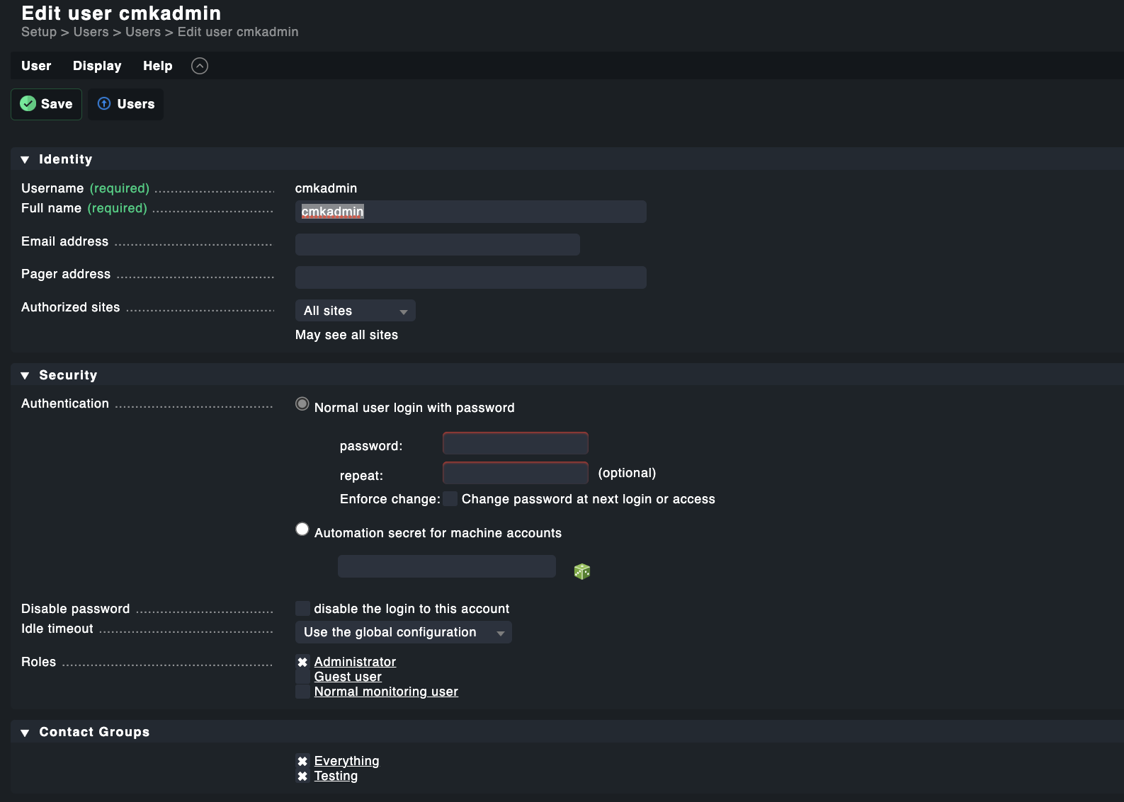

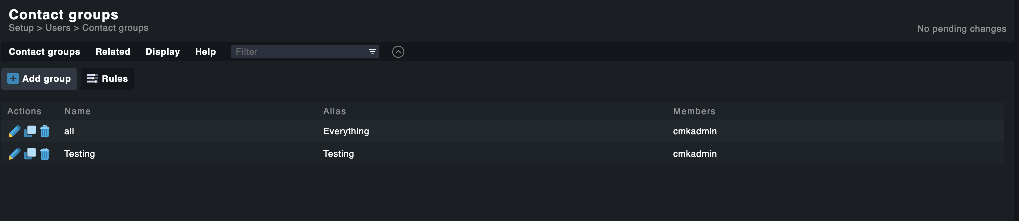

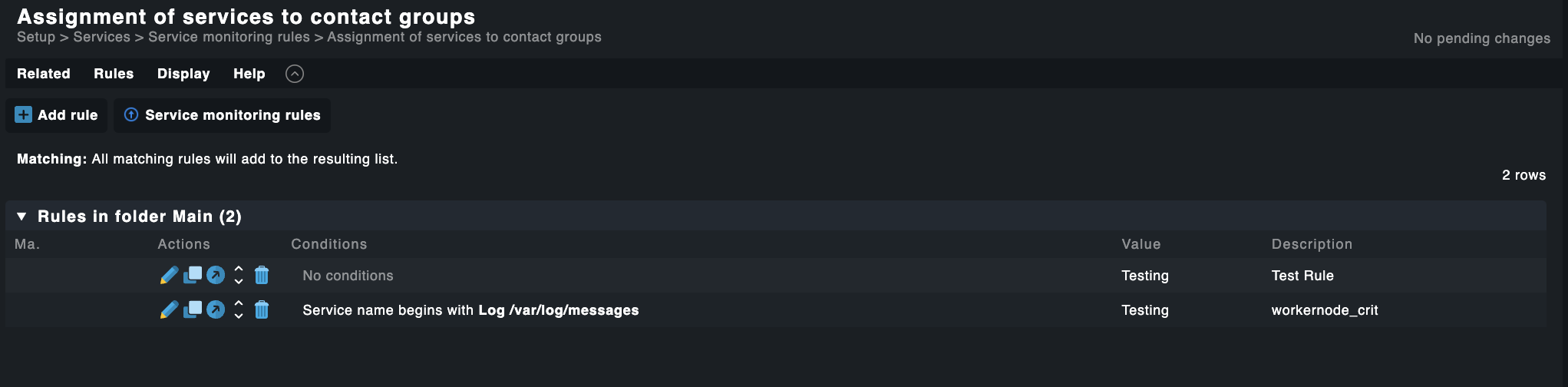

Now for every Host I have set a contact group of “Testing”

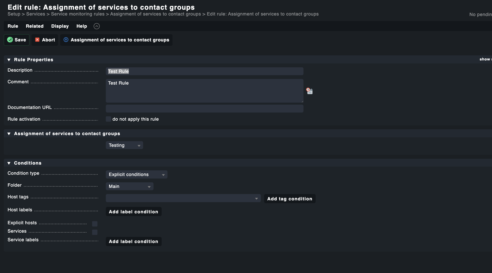

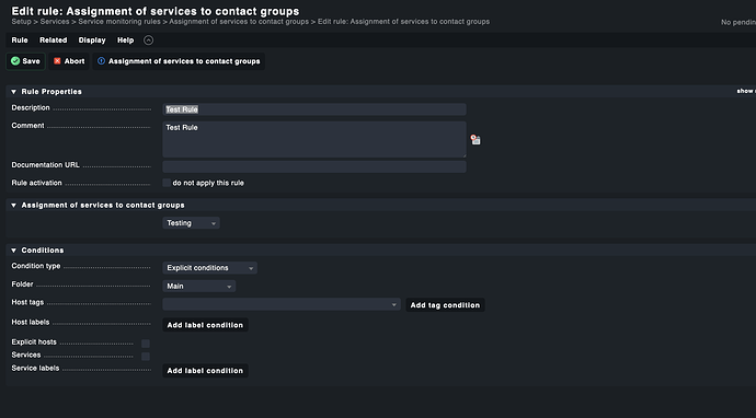

Then I assigned service to contact group

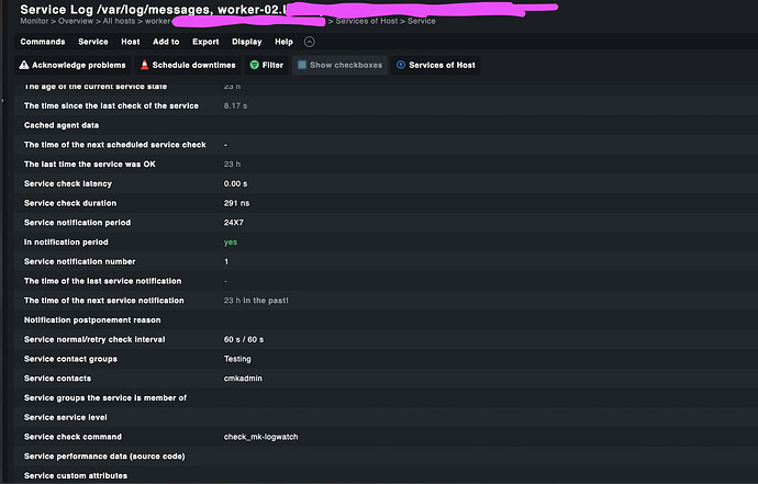

This is my service setup which got a Contact Group

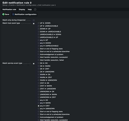

I have tested my slack setup and its working on Node UP/DOWN, but not regarding the log.

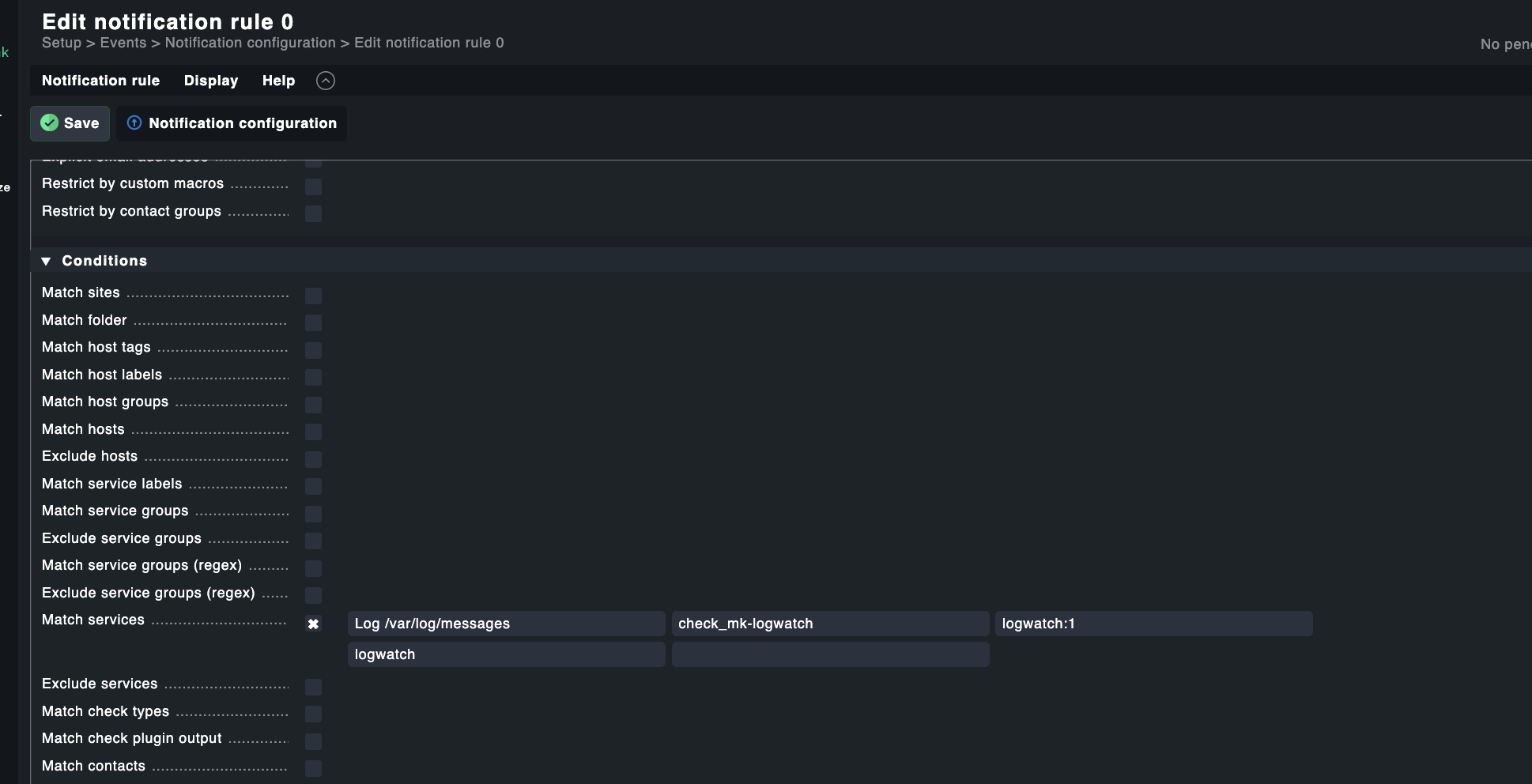

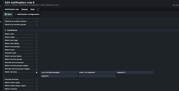

However when I go to notify menu when I trigger to generate CRIT LOG , that log is showing under Monitoring> Host however , but notification is not generated, this is my slack rule setup
I tried also something like this but it didn’t seem to work

Hi @ronald_sp,
I don’t see an obvious error in your rules so my suggestion:
remove the conditions while testing and then add them one by one, to figure out which one stops your notification from being created
but more important:
use the analysis feature incl. the replay option as explained here: Notifications - via Email, SMS, Ticketsystems and more
