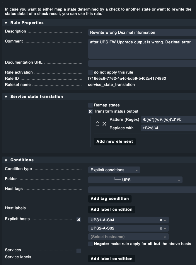

So i tried creating a rule Service state translation which should rewrite the information given by the UPS.
I used Transform status output
Pattern (RegEx) [1].[0-9]$
Replace with [0-9]0
It wont work. The rule is marked green but it does nothing. I tried a lot of different Regex Pattern which in my world should work :wink: .

No, your rule looks right to me. (At least if the conditions/hostnames are correct).
Maybe it’s the \b at the end of the pattern. It marks a word-boundary (something like “end of word”). To be precise: it is the change from a word-character to a non-word-character.
If the original output is actually 4.9hz (no space between the 9 and the h) then this won’t match.
Try dropping the final \b, i.e.
\b(\d*)(\d)\.(\d)(\d*)
Update: One more thing: you should restrict the rule to the service in question. Else it will translate the numbers on these hosts in every service it finds and where the pattern matches.

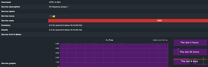

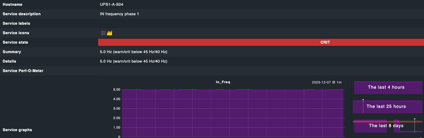

Can you show a screenshot of the service so I can see the exact output?
Sure, here you go.

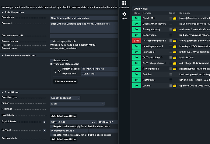

Thank you. Okay, maybe it’s the \b in the beginning as well. I assumed the number is somewhere in the middle of the text. Try just
If you like, you can also add the “Hz” literal, but then you have to put that also in the replacement string, like so:
Pattern:       (\d*)(\d)\.(\d)(\d*) Hz
Replace with:  \1\2\3.\4 Hz
Thank you !

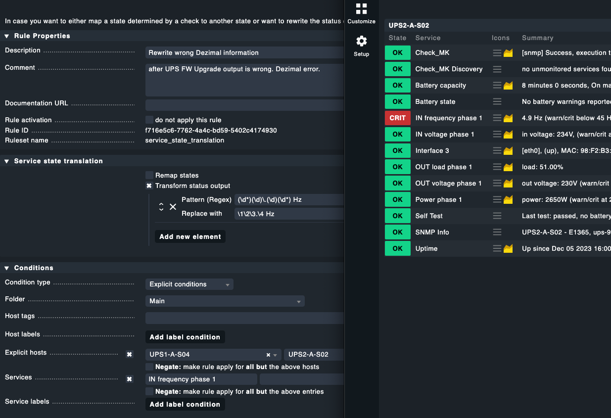

Sadly no change. I put in another screenshot, maybe i overlook something ?
I don’t see anything wrong. To check if the rule applies at all, I’d now try just Hz as the “regex” and Hertz as the replacement string. Just as a test, without any fancy expressions.
If that doesn’t work, then it must be something else.
Ok, it is something else. Seems like no rules are applied at all.
