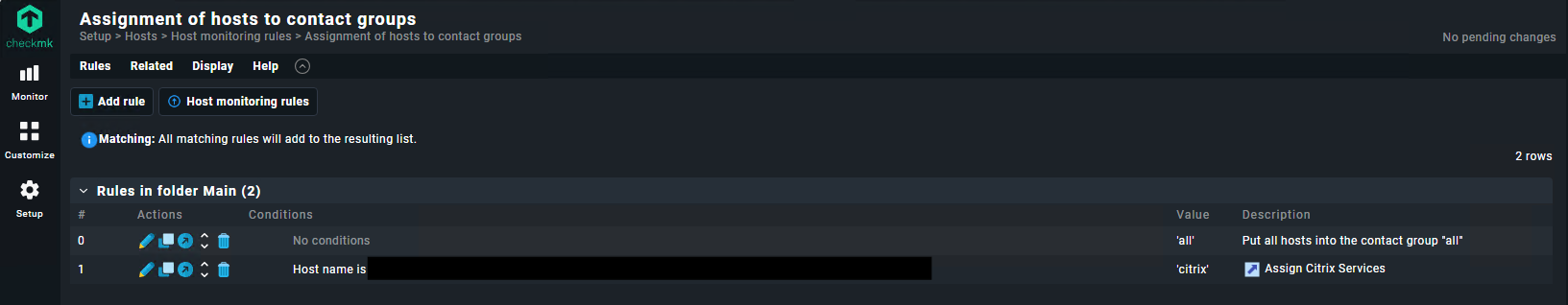

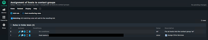

I am assigning contact groups to hosts using “Assignment of hosts to contact groups” (rule is base on a host tag).

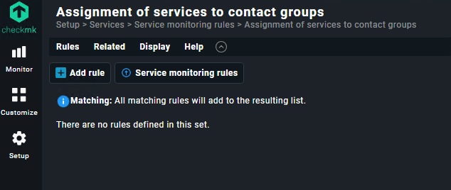

There are not rules in “Assignment of services to contact groups”, so the expectation would be that the services of a host have the same contact group as the host.

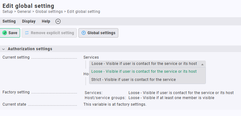

Can you explain what are trying to accomplish with that? Usually contact groups are used for notifications or to control access to Checkmk. If you need more strict access requirements you can change the following option and then explicitely define the service contact groups:
Ah, sorry for the missing context. I discovered this problem because hosts notifications are sent, but service notifications are not (well, they are, but only to members of the contact group “all”). Notification rules are fine. THe setting you mentionned are both set to loose.

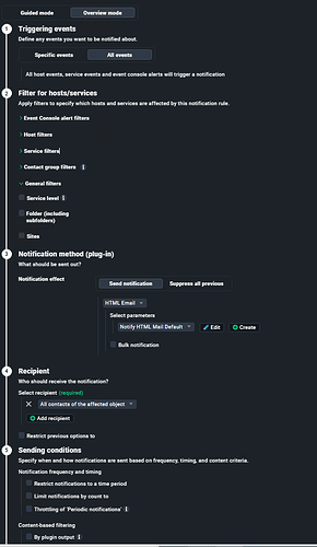

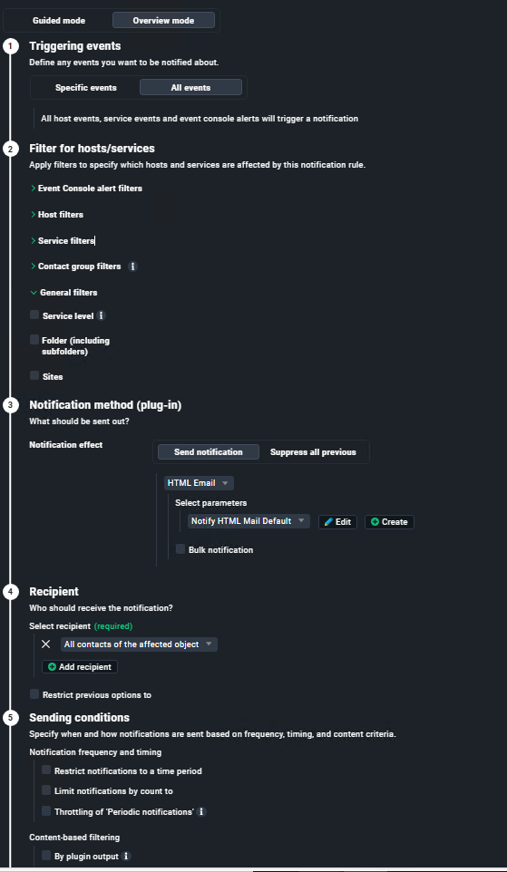

Can you share details about your notification rule?
I added a screenshot below. Really simple.
I can also use “Test notifications” to reproduce this issue. The recipients listed in the predicted notification also match the behaviour i see (host contacts missing for service notifications).
Do you have any other notification rule in place? If not can you modify the rule to send to a specific email and add your own email manually? after that trigger a service test notification.
Yes, i already tried this and it works fine for both service and host notifications. But then changing it back to “all contacts of the notified object” it stops working again.

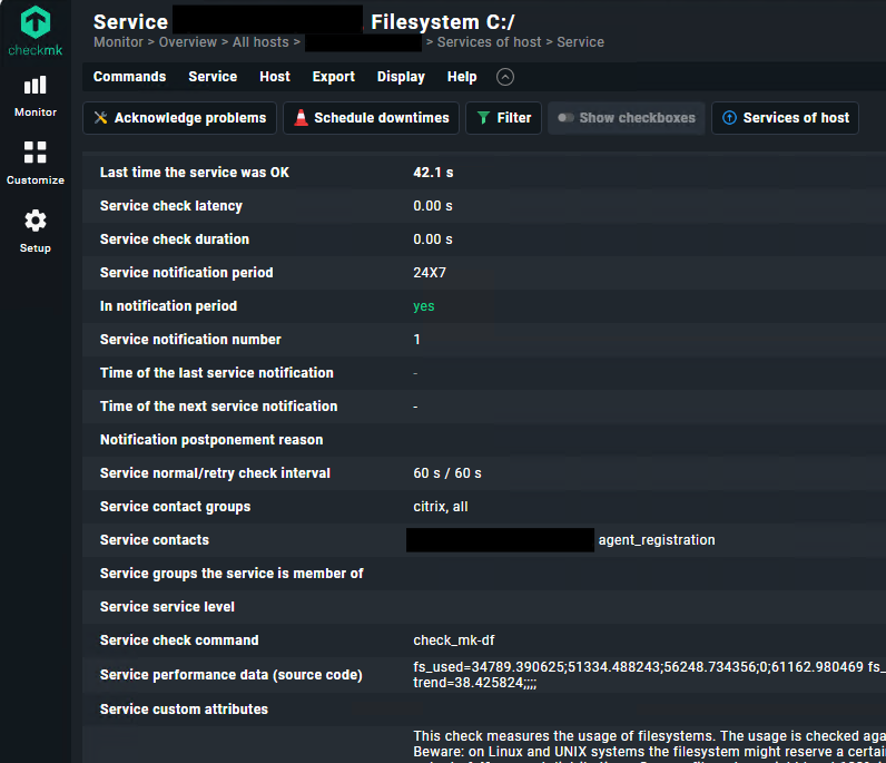

I am sure this is not a notification issue:
When I go to “Monitor > Overview > All hosts > myhost.foo.bar” I can see the correct groups assigned to the host. However, in “Monitor > Overview >All hosts > myhost.foo.bar > Services of host > Service” I can only see the contact group “all” but none of the expected contact groups.

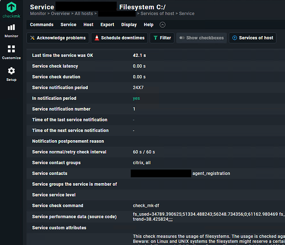

While your explanation seems accurate I don’t think it matches any of the actual behaviour of Checkmk.
I actually just tested this with another instance of Checkmk running on a separate network. Despite the settings surrounding contact group assignments being the same on both instances, the behaviour is different. There, contact groups are inherited correctly to the services.
Here is the proof:
Resulting in:
On the affected instance I also just upgraded from 2.4.0p17 to p22, just to see. The instance where it is working is on 2.3.0p22.
and how it looks on the CLI
cmk -D myhost.foo.bar
This command simply dumps what i also see in:
Monitor > Overview > All hosts > myhost.foo.bar —–> Expected contact groups visible
Monitor > Overview >All hosts > myhost.foo.bar > Services of host > Service —–> Only “all” and explicity assigned groups visible.

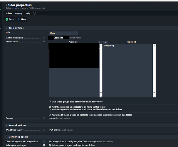

Just to confirm: there are no contact groups assignments being made on the folder (or parent folder) of the host or even in the host properties itself?
(This also disables the implicit inheritance that Bernd explained and you already checked.)

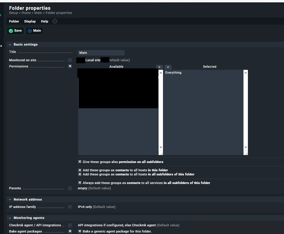

Thanks guys for your help, finally I found the cause. There was indeed a permission on the Main Folder. I think I saw it before, but assumed it was some sort of default config. I cross-checked on the other instance and did not find it there. I removed it entirely and now the inheritance is working as expected.
