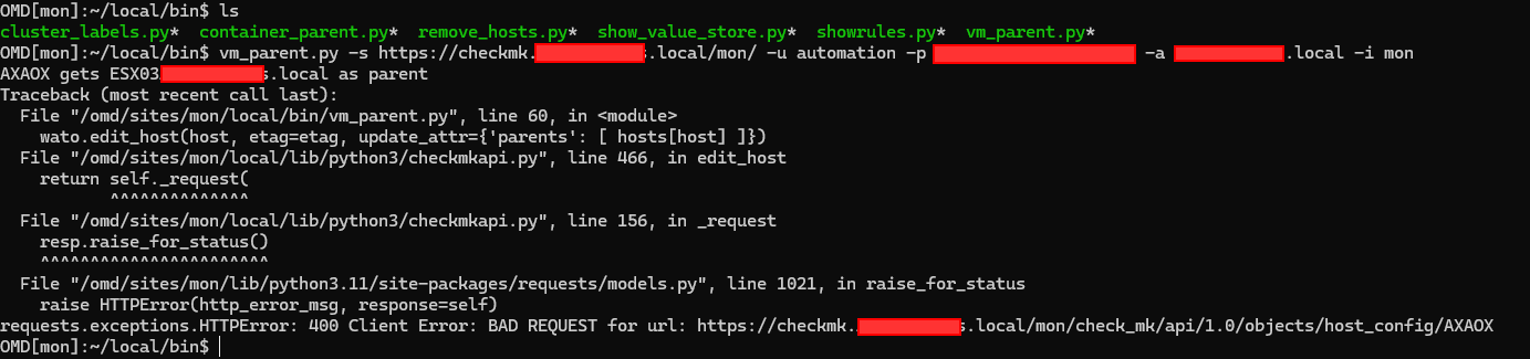

@kdeutsch
Thank you for handing me the solution. However, when trying this out, I got hit with a few errors. For host AXAOX, it finds the Parent element, but fails to adjust it.
I don’t see any blocked traffic over firewall. Has this to do with a PUT request that fails?

@r.sander
Version 2.2.0p31. Extension does mention Req version 2.2.0p22, but I thought anything above would also work?
I have it running on 2.2.0p30 and see no issue.
You will have to debug this yourself or we could arrange a paid support call.
Hi @dries,
I get the same error message as you under 2.3.0p6. But when I stop and start the site afterwards, all changes are displayed. After activating the changes, the parents are entered correctly.
Karl

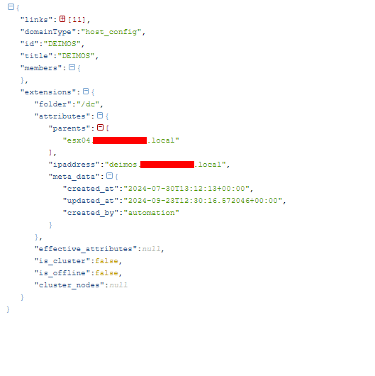

Since sander his script did not work for me, I decided to create my on bash script to retrieve the parent of each host and to update it in case it changed. For those who want to use it, you can schedule it to run every x-hours with cron.
It’s a little specific towards my environment, but just putting it out here, you can always change it.

        DATA=$(cat <<EOF
    "attributes": {
        "parents": ["${HOST_ESX[$HOST]}"],
        "ipaddress": "$HOST.xxxxx.local"
EOF
        # Perform the PUT request with the If-Match header and ETag
        curl -s -u "$USERNAME:$PASSWORD" -X PUT -H "Content-Type: application/json" -H "If-Match: $ETag" -d "$DATA" "$PUT_URL" -o /dev/null
        echo "Updated $HOST with parent ${HOST_ESX[$HOST]} using ETag $ETag"
